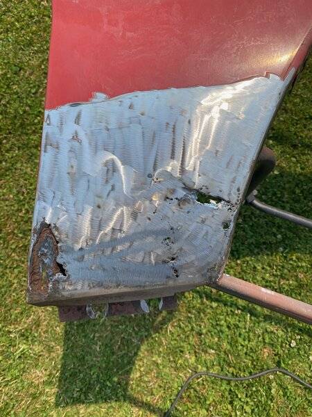

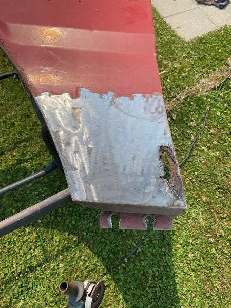

In the meantime we did the home made patch for the right fender the other day and I finished it today during my lunch break.
Nice job! Any pics of the fender patch construction and repair? I have a nice fender that needs a little rust repair in the dog leg area. I wish to keep it as a spare.
