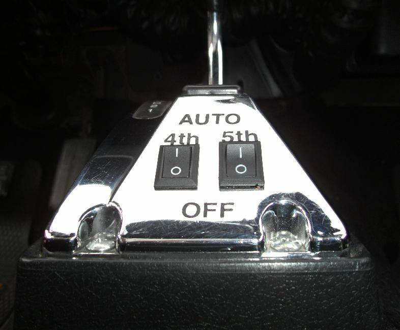

Decided to be less technical and call them 4th and 5th instead of OD and lockup. :D
Shifter art for the man cave I don't have.:D
