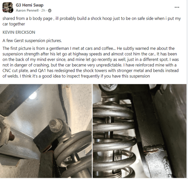

easy fix ....retro fit the HDK upper shock mount and support hoop. Would not be the first to make the change. and while you are at it, likely remove an inch off the control arms and bring your wheels / tires inward. Some even switch to a longer shock / spring combination .....and get a nicer ride.
BTW.....the HDK remedy / fix for the Gerst failure is now available in steel and aluminum. The 100% bolt on chromoly support hoops complete the install. NEVER a failure in over 2 decades,

Cap was crap from the get go. Design wise....their rack and pinion / coil over design utilized OEM spindles with Rub Goldberg steering arms / lower ball joint. the the scary results being massive bump steer and reverse ackerman.
from CAPs building /fabrication standpoint....too many pretty migg welds that did not penetrate, while they may have looked good on the surface, many broke right off. Being CAP was right in my back yard (Michigan), I have personally seen many failures that resulted in crashed cars.

Cap was crap from the get go. Design wise....their rack and pinion / coil over design utilized OEM spindles with Rub Goldberg steering arms / lower ball joint with the scary results being massive bump steer and reverse ackerman.
Gerst is / was obviously a good salesman....I'll give him that. He called me twice and lied about his intentions to pump me for info. The following week (in 2016) he announces he knows it all and is now in the rack and pinion / oil over conversion business. That BS doesn't go too far with me.

QA1 didn't use CAP's coilover conversion or rack at all, and made some changes to their torsion bar K frame. And yes, from a fabrication standpoint CAP was crap. But if you're buying a company, a company with a few good designs (LCA's, strut rods) and bad fabrication is a good choice, especially if you're going to fully take over production. The crappy weld issue was totally solved the minute QA1 bought them out, as they have great fabrication/production. CAP may have been in your back yard, but I ran their UCA's, LCA's, and strut rods on my Challenger. I still run their strut rods, as there is literally no welding in their construction and they're a sound part (70k street miles on them without a hiccup). I had no issues with their UCA's, although I saw the failures and don't run them anymore. And I had a weld crack on one of the LCA's, although honestly that was over 50k miles in.
But even having had one of the CAP LCA's fail, I have no issue running the QA1 LCA's on my Duster because the welding issues were solved. It's also how I know the design of those parts didn't change, I can hold them up side by side with the CAP parts.
And again, all of that misses the point. QA1 is buying the designs and then re-working them for production. Buying CAP, keeping their designs and losing the CAP name/reputation is a great move for a company, they get the designs cheap. And yeah, the QA1 versions of those parts are great. Gerst is the same thing all over again. QA1 will fix some of the fabrication issues and have a great part that will be ready to compete with RMS, and you, as soon as it hits production. Given the size of QA1 and their distribution they will be formidable. Like, I can go on Summit right now and put in an order for their full conversion, super easy.

And yeah, it looks like they already fixed the uprights

I'm not sold on the K Member . flimsy looking frame mount points, new shock tower design looks better but we'll see.
