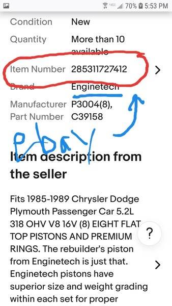

Do you have a part number for those pistons? Every time I try looking those up I can only find 360 pistons in general. Sorry, I didn't mean to highjack the op thread I'm just trying to get the part number of those pistons.
