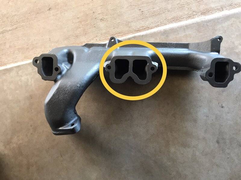

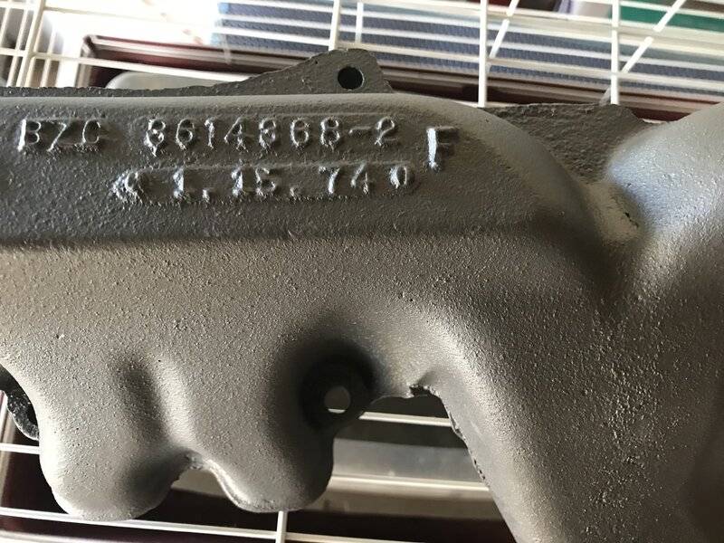

This manifold corresponds to a 340 number but has a date of 1/15/1974.
Also, the exhaust ports in the center divided.
I thought the center two ports on 340 manifolds were one hole like this one here …
Is the 3614368-2 a 360 manifold? If it is a 340 manifold why does it have a casting date in 1974? What is the corresponding RH side manifold? 3418623?

360 manifold. Same number continued to be used on the 360 after the 340 was discontinued.
The 340 (and then the 360 without air injection) manifolds had individual exhaust ports, the common center port you have pictured was a 273/318 thing (I'm guessing that manifold was on a 340/360, you can see the carbon witness marks from the port mismatch).
Hint- 340s used a flat exhaust pipe flange, 273/318 used the flare/bell flange. 360 varied by application.

3614368 is 72-74 340 and 360-4
I *believe* it's a 3418623- should be a common number shared with other applications beside the A body. Uses a common center port and bell exhaust unlike earlier 340 RH manifolds.
(pic stolen from @davescuda 's for sale ad) [SOLD] - 340 - 360 exhaust manifolds | For A Bodies Only Mopar Forum

The 340/360 used identical casting numbers in many cases, but a casting date of late '73 and after (post 340 production) would indicate 360 usage.

I like the center port divider! How far into the ports does the divider go?
