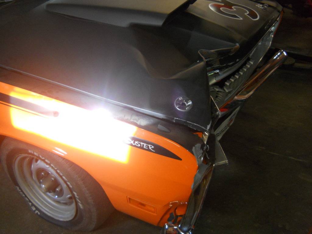

The wreck was caused by poly strut rod bushing coming apart and a stripped upper control arm bolt. The chinese Style with the flat on each side. Lesson learned. Back of the tire hit the fender when he left off in second.

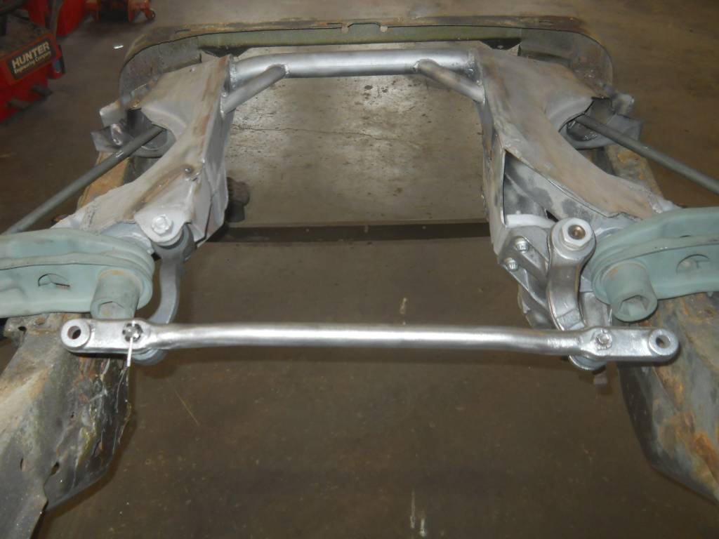

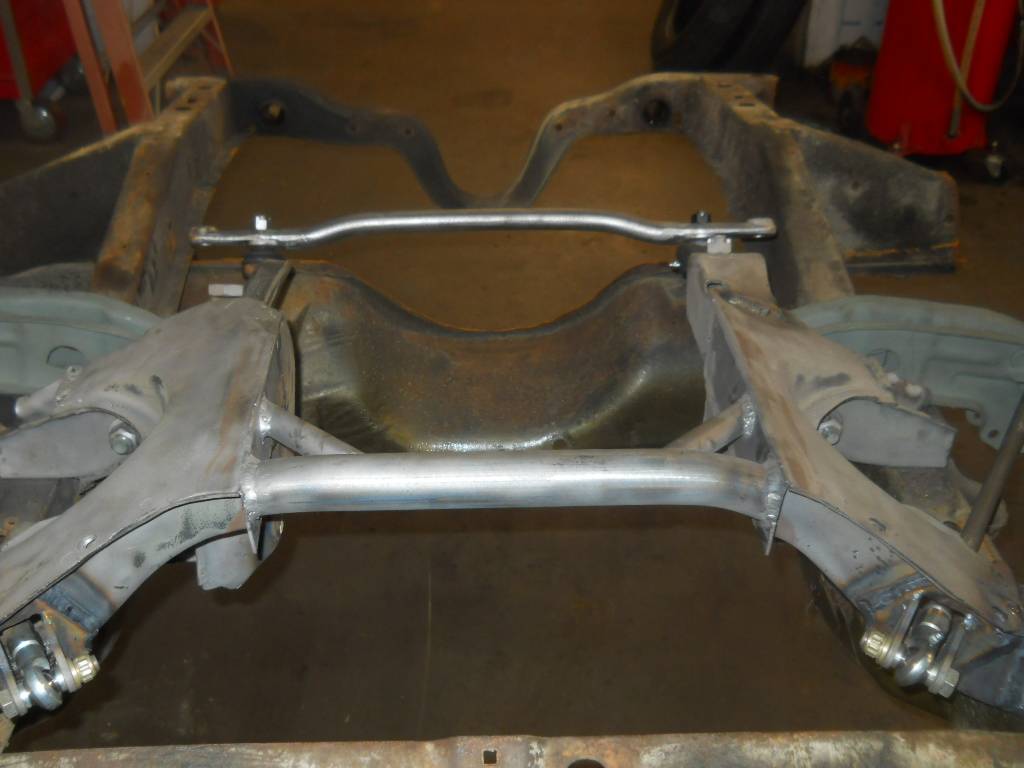

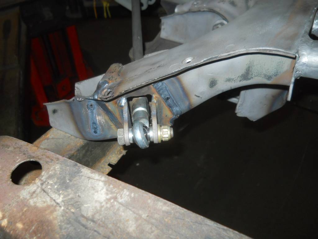

I knew they were bad and we were about to pull it in the shop for a new K-member we built with Heim joints on the struts and 73 steering. . (pictured below) My son took it for one last ride. little did we know

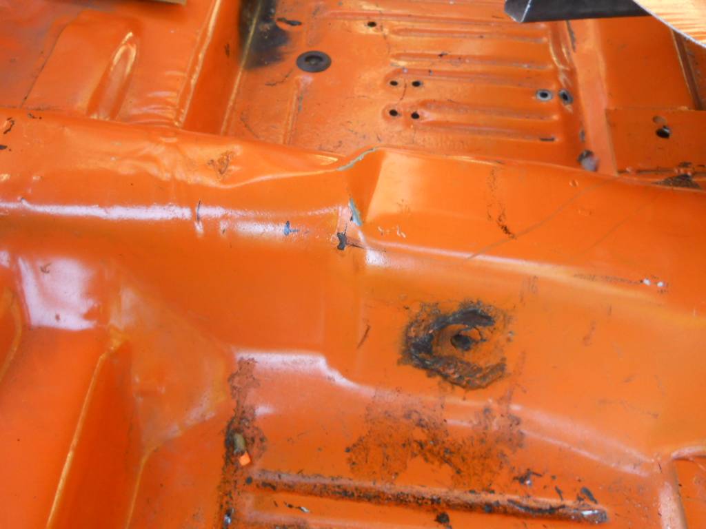

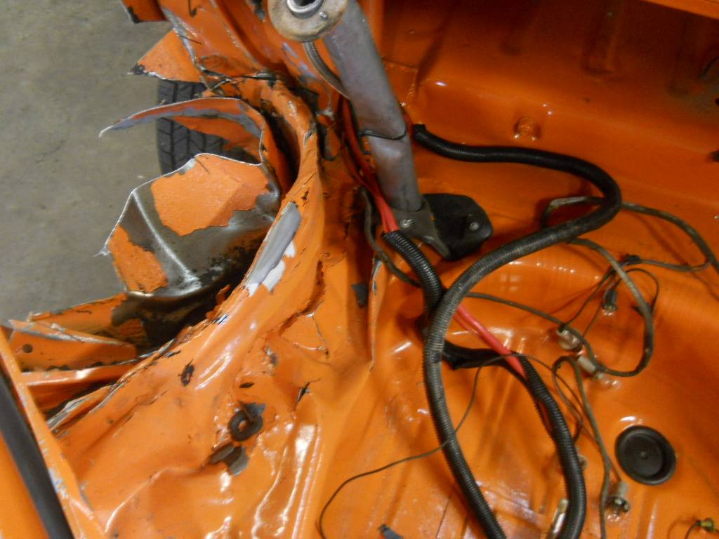

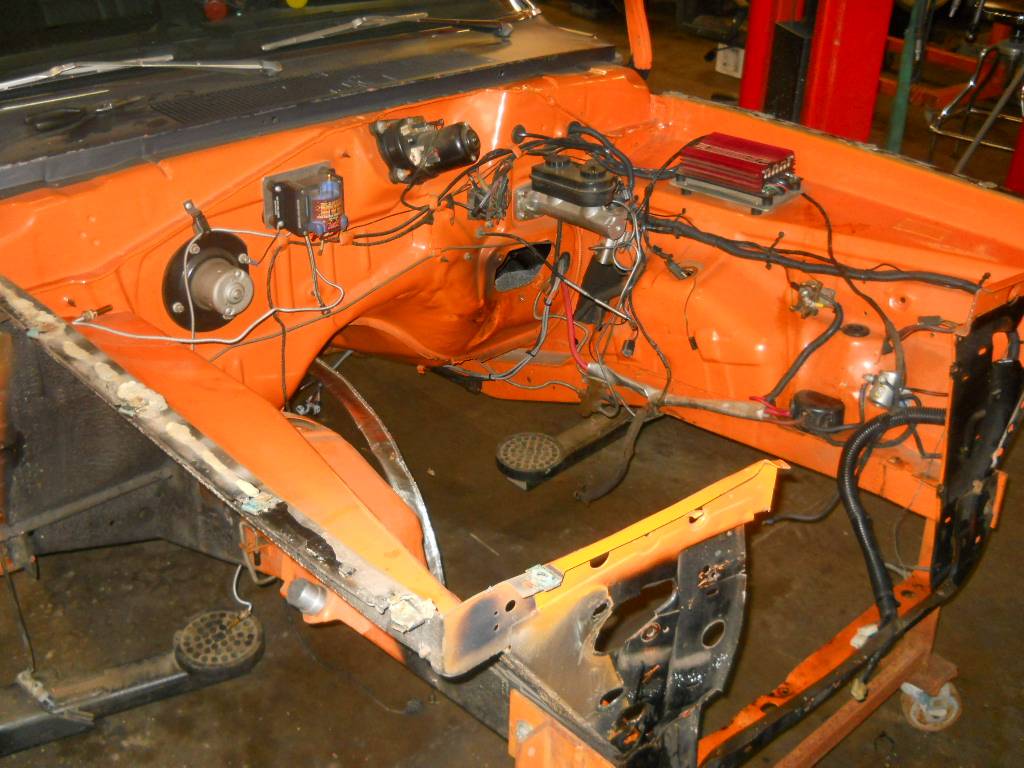

Well this body is gone to the grave. The quarter hit was so hard it buckled the floor right behind the shifter. With the the cage in the car and having swing outs that is where the weak spot was in the frame structure. The pole hit the down leg plate in the trunk where the cage was fastened seen in the last pic.

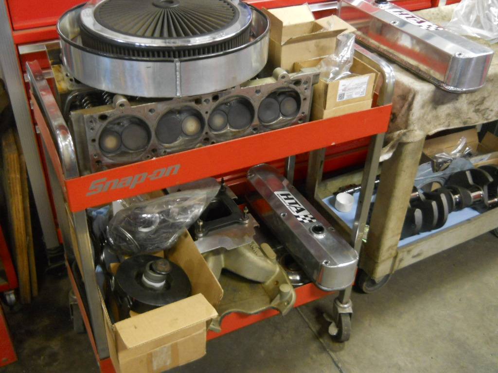

What is not shown in the pics is the chassis Damage. The P.O. mail box was on a cement slap that is not in the pics . It tore the 2 inch headers right out from under the bottom of the car plus other suspension damage. So the motor was tore down for inspection. Its fine but you know how it goes. Never leave well enough alone. So besides a drastic weight reduction to the car. And now that the motor is apart. The son is insistent on More Power!
