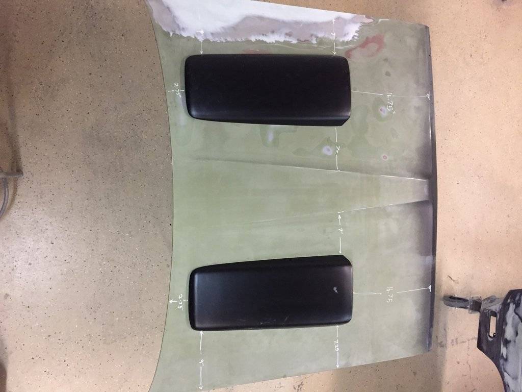

Hi all, after reading the information in this forum and needing to mount some scoops myself I came up with the following measurements on my hood. And after drilling the holes in the hood I found these measurements to be spot on to the link that was given earlier showing underside of the grey demon hood.
These measurements are as follows.
Set the scoop on the hood with the mounting studs attached and use the following measurements
To position the scoop, mark around the mounting studs to drill the holes.
From the back of the hood edge to the back of scoop 2.75"
From the back outside scoop edge to hood edge 7"
From the front outer edge of scoop to hood edge 9"
From the front inner scoop edge to the edge of the center crease 7"
Then from the front edge of the scoop to the fron of the hoods first crease 16.25"
Hope this makes it easier for some of you, I have encluded a picture of my hood I did.
I measured it many times before drilling to make sure it was correct
Good luck
