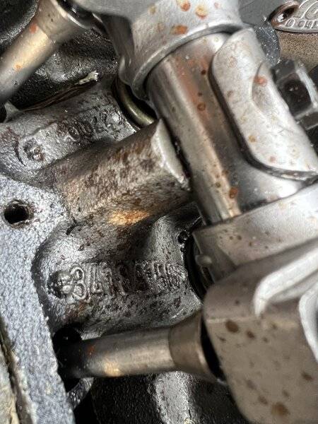

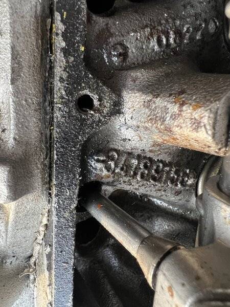

Just to make sure I’m right you’re talking about these correct?
