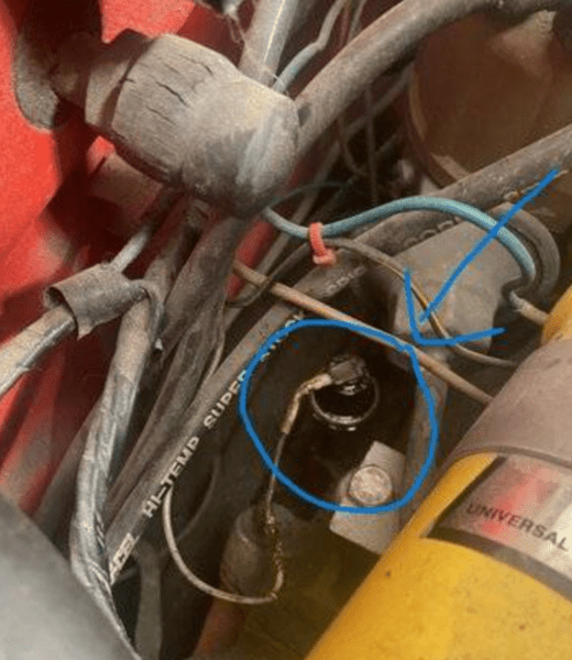

My first thought is the oil pump relief valve isn't working properly, the cars oil pressure is at around 55-60 psi.
I attached a picture, which I think is the relief valve but I'm not sure. But the thing in the picture was also covered in oil (Maybe from all the oil spraying? I'm not sure)

the sending unit has no effect on oil pressure-- it's only a "switch" that reads the pressure and transmits to your gauge. leaking 5 quarts from there would be quite a feat.
i'd suspect else where... either like at the filter like i suggested above or possibly you lost a galley plug out the back of the block.
what's the connection at the block for the filter? 90* or the flat plate?
Is it possible the sending unit is sending too much oil pressure?, and thus causing the seal to fail? The oil filter is only ~50 miles old.
The sending unit doesn't send the oil, the oil pump does. The sending unit sends the signal to the guage. Those pressures are fine. That sending unit doesnt look correct for a guage

The pressure relief valve is internal on the pump so it’s definitely not causing your external leak.
The sending unit just reads pressure and sends the reading to the gauge. It really has nothing to do with oil flow. But they can fail and when they do they leak.

You can get seepage from the sender but it looks mostly dry.
