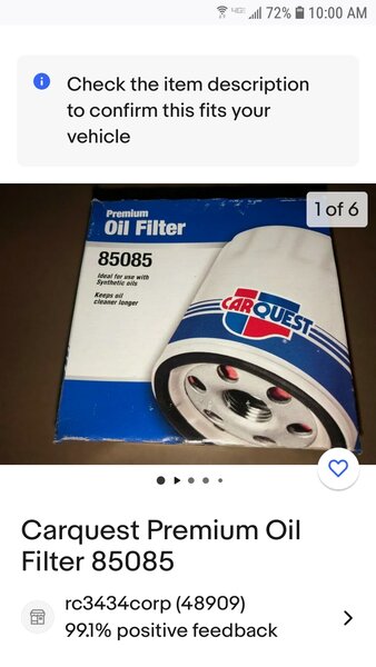

Carquest 85085 Premium Oil Filter, with Red Silicone anti-drainback.
