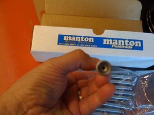

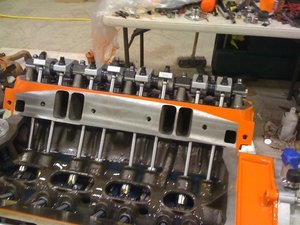

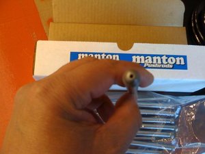

Cam Card, I used Hughes 1.6 Roller Rockers, banana shafts and hold down kit. I also used Hardened Manton 3/8's Push Rods with 5/16 Ball/Cup oil thru tips to keep Pressurized oil on the ball and cup area. That was recommended by Brian at IMM Engines. I do believe that is why it HOLDS the valve adjustment so well. JMO
I also used the COOL FACE lifters that have the EMD hole on the bottom so Pressurized oil is always on the cam/lifter contact area.
Solid Flat Tappet Camshaft Hughes HTL5660AS
Push Rods
Assembled
