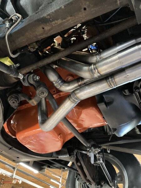

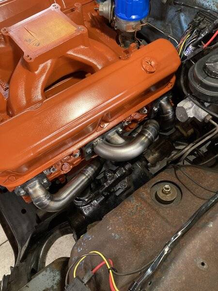

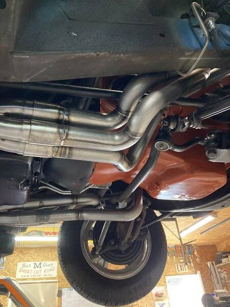

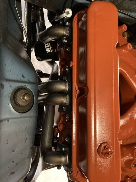

Motor is a 318/ 904 in a 68 dart. 1-5/8 tubes. They all come apart with double slip fit collectors to minimize exhaust leaks. Starter is able to come in/out and oil filter is serviceable. Mild steel but they will be coated

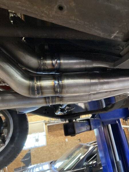

F yeah! Make me a skinny pair for a 65 chassis! Would have to take #1 straight down, steering box is in way of that pattern. Nice welds. Whats your welder set up at?
Thanks! Welder is set at max I just control with the pedal

You did a really good job engineering a quality set of headers. Great access to the starter, spark plugs and exhaust bolts. And no burnt up spark plug wires. Job well done. You could teach these so called header companies a lesson or two! The ones that think headers are supposed to be a pain in the *** to install. Like it's some sort of right of passage or something! Lol
Thank you! I appreciate it. I figured I’d make them instead of buying since everyone hates headers on a A body.. lots of thought went into the drive side. I’ll usually do a set of headers in 14 hrs start to finish both sides... Just the driver side took 10.. made sure all the plugs where good to get to and starter maintenance
Only tube I didn’t like was the number one going under the link bar.. had to for the started to be serviced..

Were you able to keep the primary tubes equal length? Nice effort.
