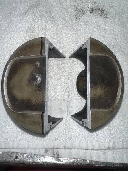

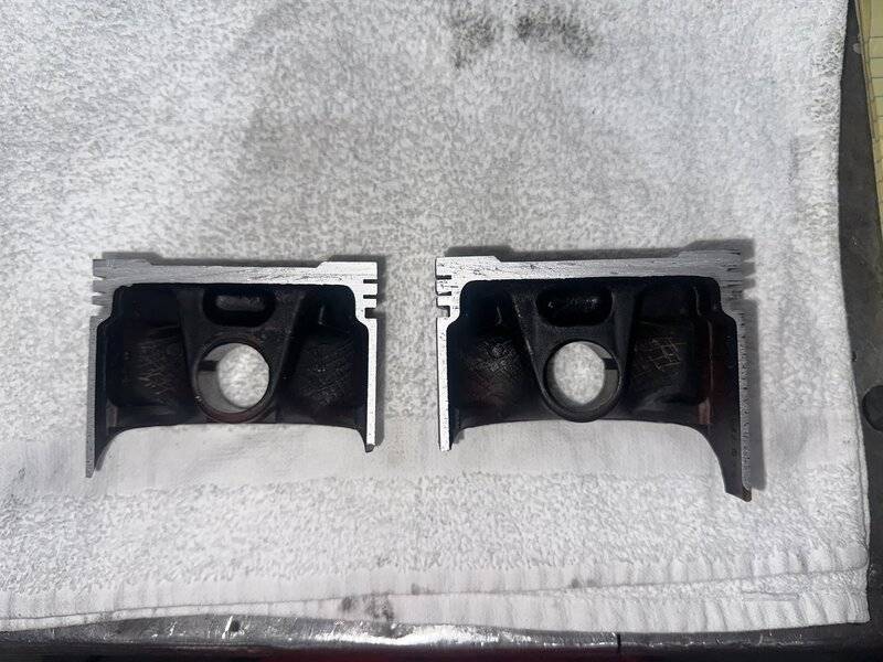

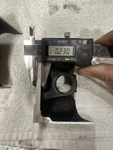

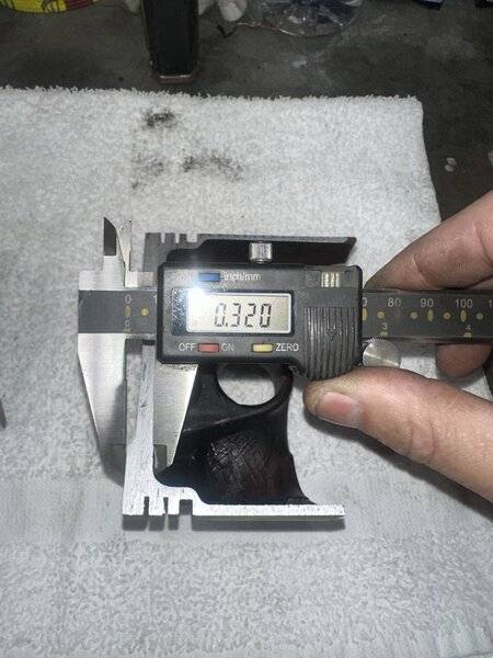

I am going to be fly cutting a stock set of magnum 5.9 pistons so I cut one with a broken skirt in half to see how thick the crowns were. The thinnest part (in the dish) was .230 and the thickest part was .320.

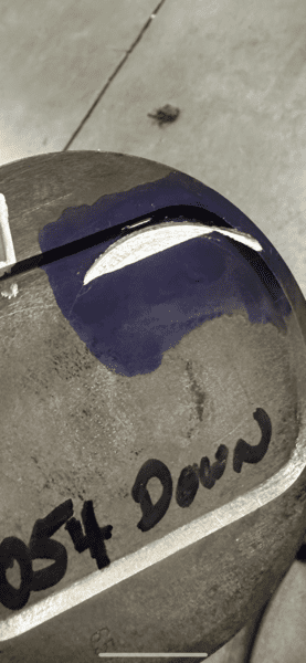

Yea I know how to measure for it. I’ve mocked it up a bunch already and and it’s very close with the cam in at 109.5, it won’t have more than .020 on the intakes right at the edge of the dish. Before I got too crazy I wanted to know how thick the crowns were and how much they’d need cut.
That piston above was cut with a 2.05 fly cutter I made from an old valve. I’ve since made a new one with a 2.100 valve for a little more radial clearance.
....and you're SURE.....like 100% and not 99 that's that measurement is correct? It just doesn't seem possible they are that close. I guess they could be. If they are, I'd be skeered to cut those pistons. That'd be gettin that crown pretty thin, IMO.
What was the clearance with that cut? If it was enough, it might be ok. But I wouldn't cut those crowns very deep at all. They aren't too thick to begin with. That's a failure you don't want, Beavis.
I’m 100% sure and I’m cutting them if I need to. I’ll wait for final valvetrain stuff from B3 then decide how much to cut em. Thankfully most of the material will come out of the thickest part of the crown then just kiss the thinnest part.
