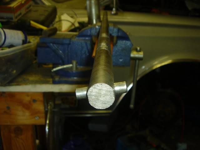

I extended an auto column to "reach' a manual box. If your handy with a welder, its easy. Mine required nothing more than a A body manual steering box and a 3" piece of steering shaft end I hack sawed off a boneyard A body car. I got pics somewhere. cut old one at pin and weld new piece in. Give yourself a nice chamfer at mating surface for good weld penetration and brace with angle iron to keep it true. Grind, fill and paint. Voila. Alot easier than pulling the friggin shaft out the column from the bottom.
