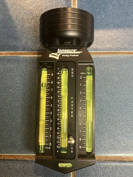

So just got my new longacre caster /camber gauge.. prior to this I was using a level and just setting uca for most caster .
I checked side to side and at 0.5 negative camber both sides.. and 1/8 toe in.. I have +1. 5 caster on driver and negative 3 degrees caster on pass side. Idk how this is even possible. I checked it like ten times..
I swapped the pass uca with moog offset bush just to get to negative 3 from negative 4.. .i can get the number down to negative 2 on the pass side if I run negative +1 camber but something is wack here. frame looks good and K member looks good. What am I missing here. No wonder my steering is sheite. Any ideas.
Everything is stock 73 big ball.. im guessing bent spindle or wonky LCA bush? Or front strut rod bush..Ill take any suggestions

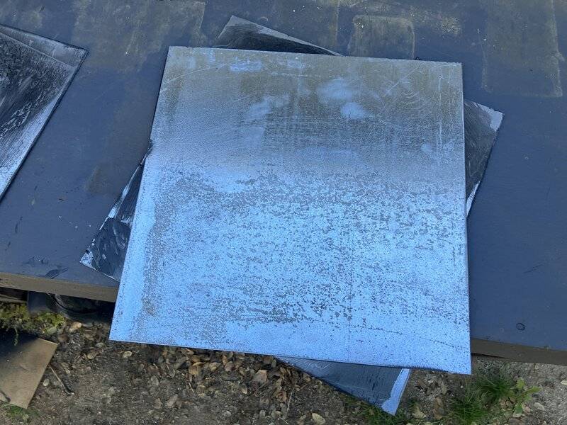

And double finally, if you don't have floating turning plates, your other option is like @Kern Dog shows. Ok fine, but, if those plates do not float on each other to relax the suspension, then you are gonna run into problems with repeatability. So say you get a reading that needs to be changed, say you change it, then you retest it, but now the measurement is really way out there! So the question is, did you adjust too far or was the suspension not fully relaxed. You could be adjusting all afternoon chasing after the right number while the whole time, it was just those slip plates. So, if you use those, be aware of their limitations.

I got the kerndog slip plates and my camber is spot on at -5 degrees both sides with caster being 5 degrees apart side to side Something is bent. Rest assured ill find it. My money on LCA
