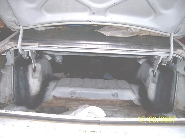

Been really fun doing this. From inner to fender lip went from right at 12" to 15".
One side looks better than the other. Never did a mini before using the old shells. Only did full tubs. Learned a few thing what NOT to do on the pass side. no huge patches to fill wild cutting. Never let a guy with ADD loose with a 4.5" grinder with a cutting wheel attached! :laughing:

Here are some updated pics of the trunk and interior areas after reattaching the trunk brackets and seam sealer applied.

Where did you get seam sealer and what is it called/brand name?
A cool, thanks Blackace.
Hopeing to do some body work in a cpouple of months. No mini tubing, just some floor and rear 1/4 work.
It' looks like brushable but it's the caulking tube set up from 3M - PN 08500
https://www.autobodytoolmart.com/p-10383-12823.aspx
I got it from the local paint house and it was $13/tube
Used about 1.5 tubes and it's on pretty thick. If I was a bit chincy with it, I could have probably snuck by with 1 tube. Figured having too much was better than the alternative and a 30 mile drive back to the paint house.
I spread it with a wet finger or contoured paint stirring stick. Funny that it says spread with a wet finger, then under warnings, "Avoid contact with skin" Gee maybe spread with a gloved wet finger might be a better description on the tube. :thebirdm: :toothy10:
