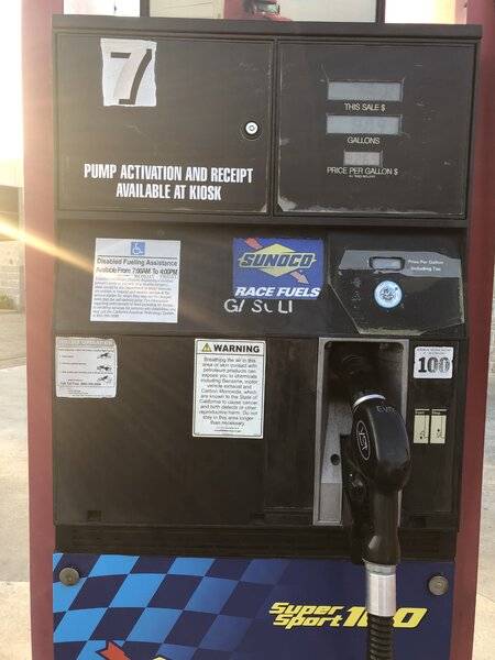

In California, I’d like to raise my fuel octane from 91 to 93 (to prevent knocking) by adding pump Sunoco SS 100 (7 gal 91 octane/2 gal 100 octane). Carburetor/1967 440 engine. No catalytic converter, oxygen sensor, etc. Can this expensive racing fuel cause any damage? Just want to double-check. Sunoco Race Fuels

Sunoco Race Fuels
It’s safe. You can run it in just about anything. Unleaded so it won’t harm cats or o2 sensors. Usually if it’s available at a pump in California it’s safe for whatever vehicle you put it in.

Sunoco Race Fuels
At street gas stations, yes. At the pump at race tracks, no.

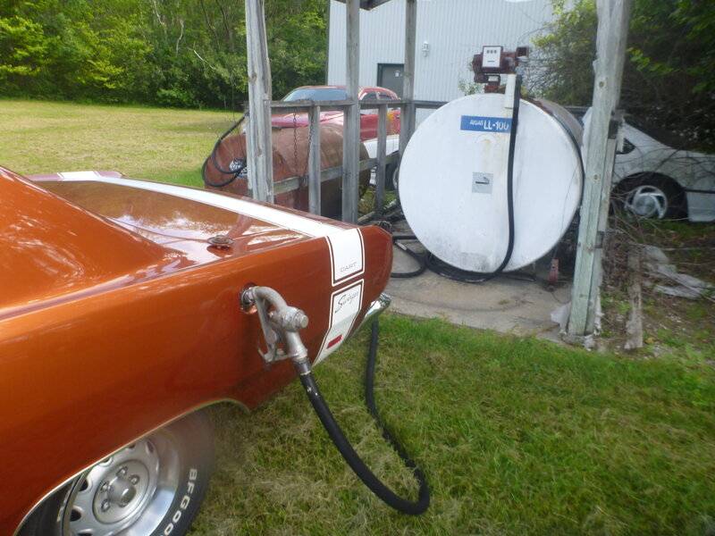

Yah.. I don't have that problem... since the "airport" is my home... or you can just buy more cans! LOL
