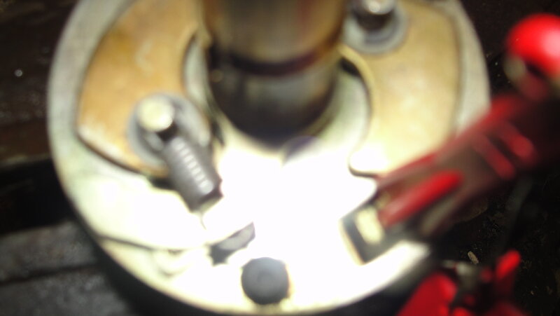

I've got the same distributor and I set mine for about 14* on a dist. machine. I can take the measurement between the plate and the stop and give you that number. @halifaxhops told me that these distributors were sold with a set of "keys". Basically different thicknesses to correspond to degrees of advance.

Just use the butt end of a drill bit to set the width of the slot where you want it. There's a chart posted on here somewhere that shows width and associated advance it provides.

Here are some measurements of the keys. There are two styles of Mallory advance and I can't recall which these specs are for.
28 degrees, .496
26 degrees, .476
24 degrees, .458
22 degrees, .442
20 degrees, .424
18 degrees, .406
16 degrees, .390
Basically, every 2* is about .016-.018 change in width. 14* is going to be in the .372-.374 range
Here are some measurements from the other Mallory set. I believe these are the numbers for the OP's distributor.
Thickness of some keys from the mallory kit.
12* .125"
14*: .140"
16*: .155"
18*: .170"
20 0.185
22 0.205

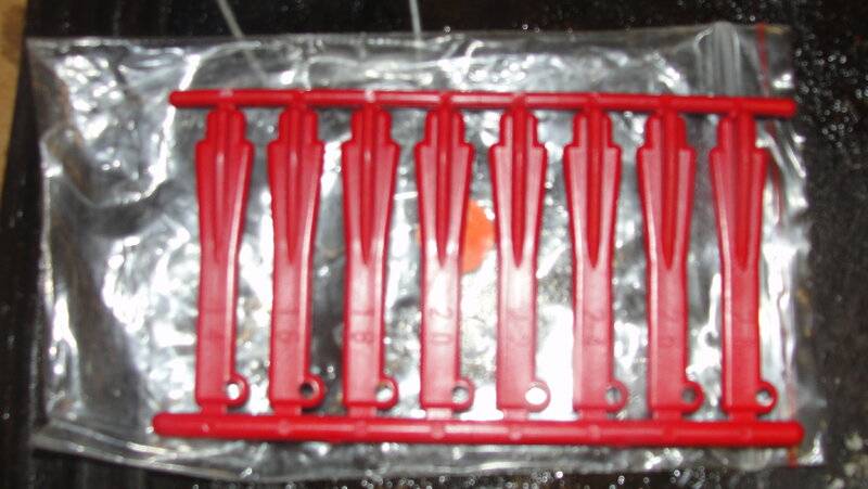

You guys make me want to cry. Why? Because people assume that everyone understands what they are talking about. I am not an electrical engineer, or distributor guru, or carburetor airbleed tip in guru either. I have FBO parts in 2 cars, one is running fine with them. The other one isn't together yet, but has the FBO distributor and module. All came recommended from a respected engine builder that occasionally makes comments on this site. Sometimes I feel like I am back in the Army, and my poncho fell apart on a forced march and now I am on the side doing push-ups for embarrassment, so that it doesn't happen again! I have no idea what those red gauges do yet, I have a set, they came with the new distributor. Just haven't gotten that far. Maybe Red Green can help me with some duct tape! I will keep watching, we're all in this together.
