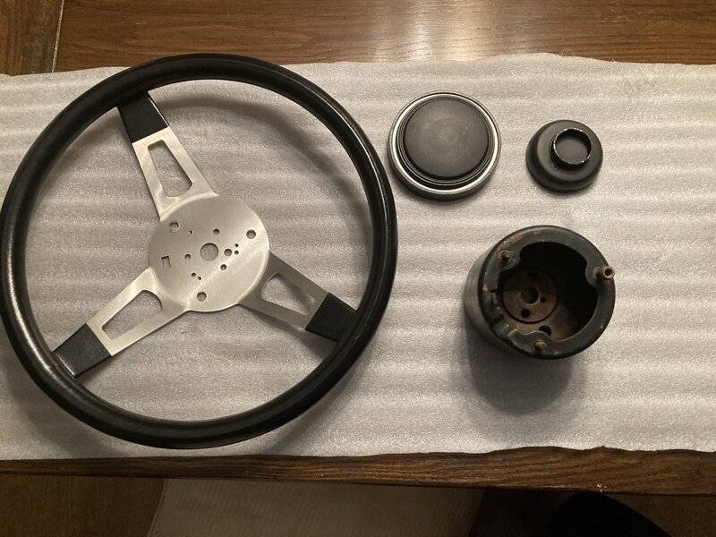

Hello, I have a new Grant Tuff Wheel and recently purchased an OE adapter here on FABO.
My question is, what horn button kit is the right one?

and below is what I have currently
The top one looks correct to me. The bottom one from grant is just a cheap generic kit that works with alot of their steering wheels.
Yep the top one. I used an original one on my repop tuff wheel and it fit perfect. That horn button was used on a bunch of applications.
