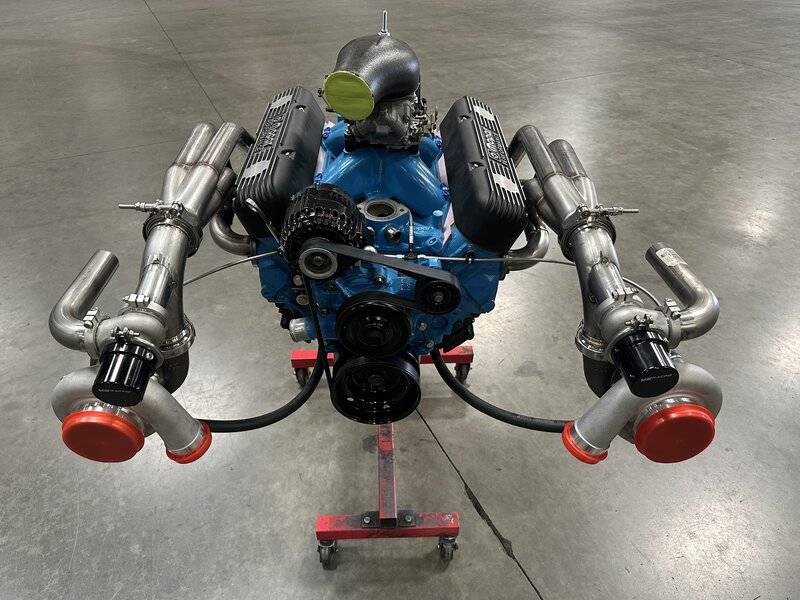

Oh cool, that's going to be awesome I'm sure.Building currently specifically for drag week stick shift class
Twin turbo W2 small block magnum 5.9 with a 6 speed. It better be awesome.Oh cool, that's going to be awesome I'm sure.
Factory block ?Twin turbo W2 small block magnum 5.9 with a 6 speed. It better be awesome.
Straight out of a 2001 dodge 2500Factory block ?
****, nice.Straight out of a 2001 dodge 2500
There’s a video of it on the run stand in my thread. I thought you were following.****, nice.

Necessary for what? I’m planning to ask this small block to make ~950 and I think I can make it survive there. I’m not sure where the limit of the magnum block is, hell maybe I’ll find it.Maybe a big block swap isn't necessary
I have so much big block stuff, I was planning to build a 451. I just didn't know twin turbo & 5.9 magnum was a thing, lol TT5.9mag duh...I guess you already done known this.Necessary for what? I’m planning to ask this small block to make ~950 and I think I can make it survive there. I’m not sure where the limit of the magnum block is, hell maybe I’ll find it.

Well, I drug home another one
Very nice, quality looking piece dude.View attachment 1716330471
Yup, this is the second twin turbo 5.9 magnum I’ve done. The first one was on a factory ecu with factory fuel injection. That one on gasoline made 650 for a long time. This one is a little more serious amd is blow through carbureted.
