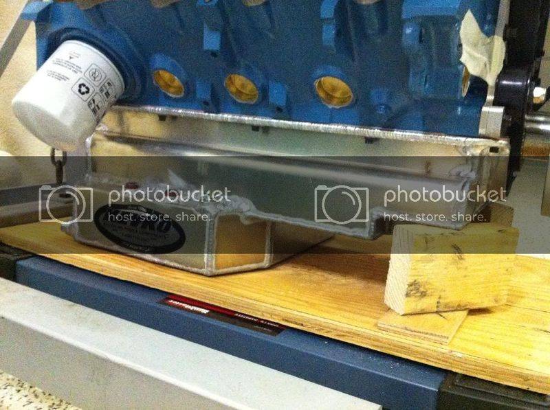

Can you give us some more info on the K member and front suspension?
Tory’s K.... nice piece
A couple cars have completed drag week utilizing them.
Link to this k member? That's a awesome piece
What lower ball joints does it use? I can't read the decal, who's K member is it? I'd like to have something like it on my street/strip Dart.
I am going to help him set up a Facebook page soon, maybe even this weekend. He is sending me lots of pics and I will share a link when I get it up and going.
aftermarket K afforded the room for kick outs on both sides... if I had to do it again I’d gone a little more depth. But this one did serve me well as it just barely touched the ground on my wheel stand. Still enough to damage it, but no oil loss.
