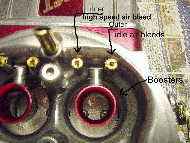

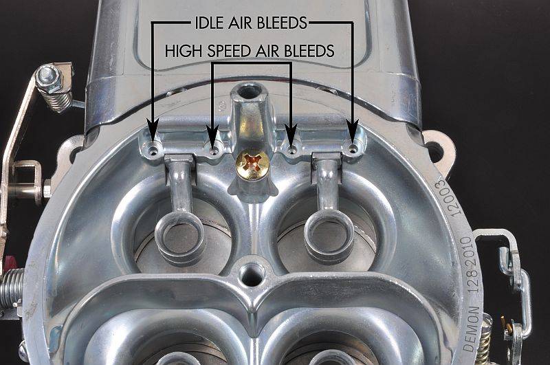

Bigger Air bleeds . More air less fuel. Easy to change on the road by removing the air filter. If you change over to removable style.
also square the carb so your not into the PV at idle. Idle off the secondaries and leave the primaries square or drill a hole in the venturi valves as pictured
