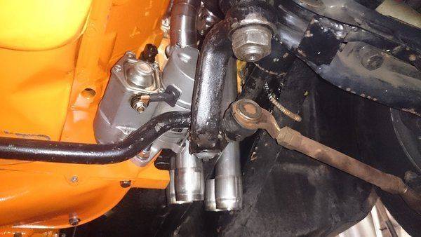

Hi all!!! Here is an update on the headers fabrication. This is taking much longer than I expected, but since my car is an early A body and the room is tigth I wont complain about that.
They are being made in stainless steel and right now the drivers side is finished, so they will move to the passenger side today. Since I added Power Steering and that will take some headers room against a mechanical steering box, I also moved to an Hydraulic Clutch setup to remove the Z bar and I used a Flaming River coupler for link.
Well here are the pictures, still needed more welding al this point .. hope you like them!!!
Damn, that's a lot of work! Nice job. Is there a reason you're not using pre-bent tubes?
Its only because I like that look on ss headers. The guys at the headers shop are used to work like this so I went along.
I have seen Dougs 450 headers on early A body and I didn't like them, the collectors hang too low, too close to the ground.
Wow! Hell of a job your doing there. And yea! Header fab does take a good bit of time and even more so in this case of tight spaces.
