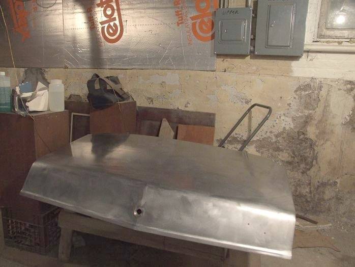

Messed around with it some today. Bought the steel and found that the 22 g will bend easy. There is no folds or creases at that spot, just a real easy curve. So I went and bought the $10 cutter from Harbor Tools. Also picked up the spot weld cutter for the drill, have all ready for tomorrow, will cut it out and fold the metal over to have something heavy for welding. Measure 3 or more times and hope I get it right. Have area to cut marked off, hopefully I can follow the lines. Pictures tomorrow. Thanks!
I have a cool neighbor. He's letting me use his portable mig welder. It's from harbor freight, MIG-100 model. Saw link online on it in operation. Found out it's not good for what I want to do. Well, I don't know how to weld anyway. Ignorance is bliss? I did find out I need to have both pieces of steel the same gauge. The 22 will burn through before it will weld together. It is touchy, I did get some welds to hold, but I need a bunch of practice. Now if it was a ford........who would care? I will look for some 20 gauge tomorrow. I can do it with more practice. Seemed to work better with a faster wire feed speed. IDK. More later. Thanks.
Found a place nearby to get some 20ga cold rolled steel. Will be able to practice tomorow with the welder. At about $6 a 12in x 24in piece, I will be able to trim it and practice until I get it right. The purists may think it's wrong to piece it like this, but I can't see spending all that money on a large piece when only a small piece is needed. IDK? The right way would be to replace the whole section, but I can't afford it now. Maybe later when I have the cash to spare I can get it done the REAL right way, but my way should be ok for now. Front valance primed, along with the left 1/4 panel. Thanks. Oh, the red you see in the one picture is the red shirt I was wearing.

Ok, a couple of pics of my practice welds. I have only welded for about 2 hrs in my entire life. 1 hr 45 minutes here the last week, the last time was wayyyyyyyyy back when I was about 17 at Wkgn East high school. LOL. Anyway, this weld ain't purty........but it does hold! One burn through. Can't be unhappy with that. Getting better. Just don't expect me to weld anything impurtant. Hehehe. Gonna try to fab a piece to replace part of the extension piece, where the q panel connects at the bottom. Then the actual q skin itself.

Louie your welding loooks good to me. Cause my welding is about the same. Nothing a grinder, body filler and paint won't hide.
Thanks. I'm gonna practice a little more, but I feel it's good enough to go with. Why I'm working on getting the metal formed and in. I agree with you also on the part about grinders and bondo, thats why they make it.
They look fine Louie, as long as it penatrates your good. Like you said it just practice.
be sure you place tack welds before you go any farther.
you don't want to concentrate to much heat in one area or you will warp your metal.
It looks like you might have your wire speed to high and its ramming the wire into the steel......try turning the feed down a bit and maybe turning the heat up a bit.
then try welding in a side to side motion about a 1/8" pattern to "bridge weld it".
your only going to probably be able to weld for about 3 seconds at a time unless your moving at a very fast pace.
the cheaper welder on thin gauge metal with little welding experience tend to want to burn through.
good luck.....and don't be afraid to give it a couple practice runs....find whatever metal you can to practice on and get yourself familiar with the feel of the welder until you feel comfortable with welding on the car.
