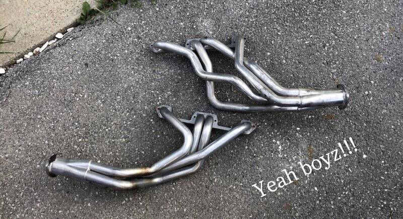

Finally got a chance to open up the Doug’s D-453 headers I bought that are very slightly used. They look much better than the hooker style headers I have on my car now. Need to order a set of gaskets, then hopefully I’ll have a chance to get these installed in the next few weeks!
Nice! Having bought Dougs and TTI's, I'd go with Doug's every time.

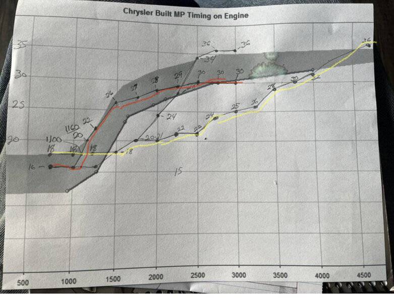

The car was running like crap the last two days at MoParty, bogging and sputtering on the autox. After MoParty, I bought an Edelbrock 1405 to replace the 1404 that was on it and it didn’t seem to make a difference. So next, I “attempted” to take apart the ready-to-run Hei distributor to recurve it… I ended up braking the distributor beyond repair. So I ordered an Fbo limiter plate and springs, new Reluctor and a 4 pin Hei module and put it all in a factory electronic distributor.
Here’s a picture of my original R2R distributor curve (yellow) and the new distributor curve (red)
The car definitely runs MUCH better now and has more power than it’s ever had, but still needs some tweaking since it still has a bog/stumble as I ease out the clutch, until the timing starts advancing.

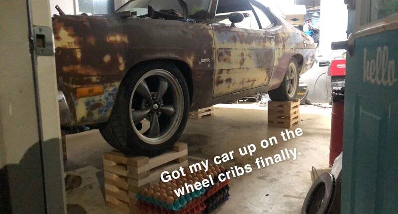

Small update. I rolled the car outside yesterday to get a look at the ride height and to get the garage organized a bit and give the floor a MUCH needed sweeping. As stated in the photo, if I actually get the suspension set as low as it’s mocked up here, I’m going to be in need of new rear springs to get the backend down at least 2, maybe 3 inches.
View attachment 1715711821 Then this evening, I started building a set of wooden wheel cribs. I used went off of the design on restocar.com but I modified it a little bit. The guy on restocar made his wheel cribs as “one piece” units that were 10”w x 14”L x 12”H. I made mine 12”w x 18”L x 12”H but I also made them as a “two piece” design. The reason for this: in order to get the car up on the “one piece” wheel cribs, here are the steps needed to get the car up high enough. 1. Jack up the rear and place jack stands under rear axle. 2. Jack up front and place on jack stands. 3. Add a block/spacer to your jack to extend the reach. 4. Jack front end up with the block and place front wheel cribs under wheels. 5. Jack up rear with jack and block and place rear wheel cribs under wheels. Now, my “two piece” design will essentially follow the same steps, just without the jack stands.
Here’s how they look at full height.
here’s the set broke down
here’s a shot showing how the two halves fit together. The bottom half is on the right.View attachment 1715711824
And here’s the two halves stacked.View attachment 1715711825
I only had time to get two of them built tonight but so hopefully I can get the others built soon, so I can get the car back in the garage and get it up on the cribs in order to get the subframe connectors installed and get the front suspension buttoned up for good.

I don’t know why I didn’t include a picture of the car sitting on the cribs in that post, but here’s one. If I remember correctly, I think I jammed a 2x4 front and back of the tires, measured that, then made it a little tighter yet so I’d for sure not get any movement.
