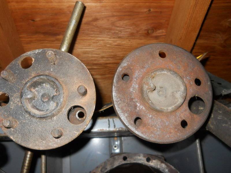

As far as the hubs. Look at the pictures they don't lie . I have several rotors for A-bodies and several hubs. I just removed some rotors for hubs for" bigboy 68" that he didn't take. I remove two and glass beaded them and noticed they were different. So I had to go out and take another one off. They were also different diameter. Never think you know it all when it comes to mopar. If your young you'll have a lot to learn. I am 64 and still learning
They also use two different axles. Some are easy to make Big bolt. Some take some time with an indexer. I have picture of the difference also

The large hub does not fit the rotor from the small hub. I believe they came off of a 67 273 commando 4spd GT I stripped That is the only car I believe they could have came from. They are all 70-72 cars that I stripped except that GT.

Here is a 67 axle from that GT next to a 70. The 67 does not have balance holes. easy to make Big bolt
