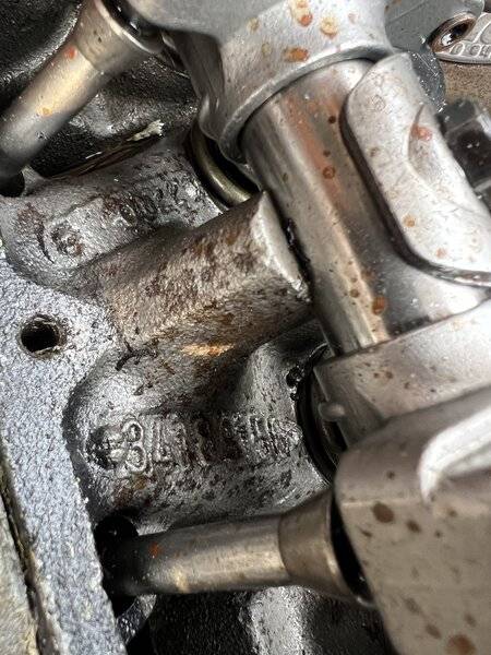

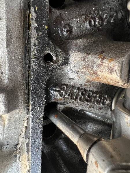

I’m planning on using the heads from the 74 engine if I can if not then I might have to order a set any reccomendations
What's the casting number on the 89 heads? If they are closed chamber you may want to use those. Hardened seats as well. I know that the 74 heads are open chamber and non hardened seats.
I believe this is what you’re asking for

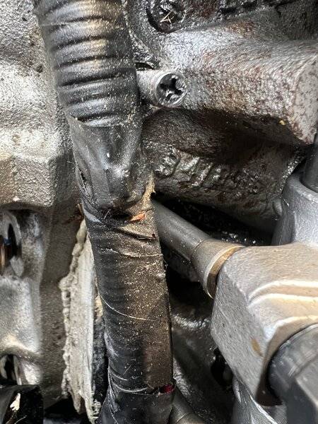

Not the right number. The casting number is cast in the head and not stamped. The 360 should end in 308.
They look like 915's. A 340/360 head with 1.88/1.60 valves. They did use that casting number on the TA heads as well with a 2.02 intake valve. #3418915
