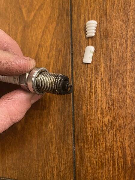

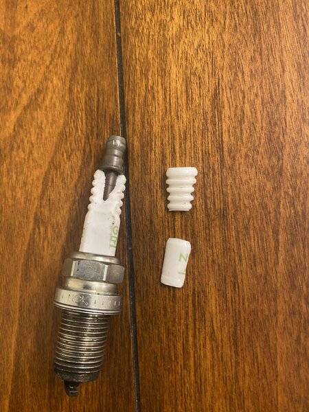

Pulled all the plugs and you can tell its running rich which is no surprise because it always has, but i noticed that the plug from number 1 had a crack on both sides. I split the porcelain off where it was split and it looks clean, no carbon tracking.
Also when i pulled the plug wire off the socket stayed on the plug, not sure if when it was crimped it cut the plug wire in half or broke it and allowed it to pull apart. They came pre crimped
