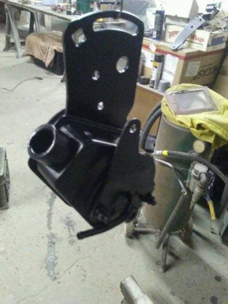

Upgraded by my 67 barracuda to the 73-76 disk brake suspension.
This pump was included with the k frame and had these brackets on it. I know it's a Saginaw pump ( I believe a later style pump). Can some tell me if those are small block brackets on the pump? If so, does anyone have pics of how it mounts on the car?
Additionally, should my crank pulley be the same for both the alternator and power steering pump pulley? I've see them with equal size pulleys or ones with a bigger power steering pump pulley.
Both of my 67 Plymouth 273s have that Saginaw pump with different brackets on the cast iron water pump. My pump pulleys are different ( have spokes ), and I suppose there's a difference in pulleys offset.
My add on pulley at crank is about a inch larger diameter than first, alt'/water pump.
I'll guess you have a different engine, aluminum water pump, etc...
I can't say anything bad about that pump though. Very easy to rebuild. Lots of aftermarket caps for Saginaw fit it.
