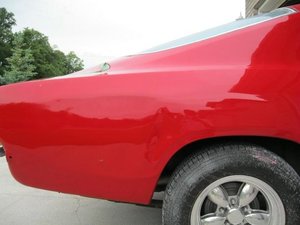

I could use some direction on how to do this.I made a boo boo on the pass side quarter,that's as much as you need to know about that, and I am trying to fix it.I have 2 spots to take care of,as you can see.

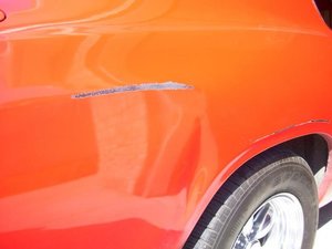

A better shot of the top scratch

I do have a couple of dents to deal with but not too sure how to handle those either.I guess what I am saying is that I have an idea of how to do this but I would like someone who knows how to tell me.Any help is appreciated or else I just take a run at it.Was hoping to do this while she was away and I can spray paint in the garage.:-D

Man that suck's You need to D.A it first ( feather edge) prime the spot's use some 2stage spotputty if needed then re prime sand the primer with 400 scotchbrite(red) the whole panel tape off the car wash the panel with wax & silicone remover tack rag it spray yourspots and clear the panel. I have never used rattle can's for this! For your dents you need to hammer and dolly them out and repeat above.
Hope this helps you out.
That's a repair that need more than a couple of rattle cans to fix properly...IMHO
It's hard to tell but I don't think that the dent will push out and not need some kinda love afterwards.
If it were me I'd fix everything and shoot the whole quarter ...
Thanks for the responses guys but I am not a bodyman by a mile,was thinking of something a little less intense.My intention is to get the car done completly down the road a few years.I will give it my best shot.If it turns out good I will take pics,if not you will never know.:-D

Well I wasn't really going to work on the dents,just the paint.I go to show n shines and I am a little embarassed by the scratches.Itsa 30 ft paint job on there now so I just want to cover the scratches.I don't think I can screw it up too much,lol.We have a Dr. Dent here,haven't gone there yet.Thanks Scott.If my fix works out I'll stop by your place and do your Dart (the early one) for free.:-D

I don't think it's going to turn out anywheres close to what your thinking...More eyes will be drawn to the repair as opposed to the scratch you have now.
You can PM me your number and I'll talk you thorough how you might want to go about your repair with what you have to work with...might save you a little ](*,)

if you da the scratch out. so the edges are feather edged it will work a lot better. it will make the repair bigger but then you could get away with rattle can and still keep a 30-40 foot paint job lol. but remember the paint just plain wont match so you will want to blend and or paint to body lines. blending is pretty easy just kinda fade out. body work really isnt hard. its not like a motor where if you get the torque off your screwed lol

Well this is it.Thanks to FABO member ROB R for repairing the scratches.I did what I could to paint,clear,wetsand ,and polish out the boo boos.No I didn't fix the dent,maybe some time down the road.It's far from perfect but it will have to do for now.8)
