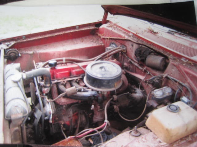

I still have the 1 in my 67 valiant I'm parting out. That auction you posted says "for parts/not working" for $195 or bo,make him a $50 offer if it's the right trans and have it rebuilt OR you can take the motor and trans set up from the car I'm stripping. I will include everything,from rad to tail shaft.air cleaner to pan for $200 but you will need a truck to come get it :)
The truck and cost of driving up there has my head spinning, I am still waiting on hearing from my brother in Dekator Ill.
That is a super deal and wish I was about 300 miles closer, I figured gas and time and it's getting expensive, I may have to just drive my wife car and see if you would separate the trans Sedanman, Are you going after it this weekend ? . Yes I will snag one up here and have it rebuilt if it's the right trans, I will keep you updated, don't let me hold you up on a sale, that is a great drive line and /6 you found :thumbrig:
