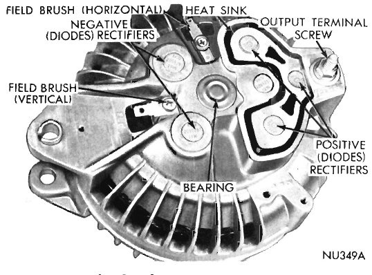

OK, if you only have two wires on the alternator, either you have misplaced one, or someone has converted the thing to the 69/ earlier system.
What does your regulator look like?
SHOULD be this:
and it should follow the diagram I posted above. Your alternator SHOULD have two field connections, like this:
or this which is an inferior 70 version
attachment.php
Now if your regulator looks like this:
Someone has "converted" your vehicle to the 69/ earlier regulator, and you may also have the early alternator, with only one brush / field connection

We need to stop jumping to conclusions. He either has the wrong alternator (and possibly regulator) which is going to affect test procedures, or is missing the second field wire, or maybe even has a "mix and match" of early / late componets. '
On top of those possibilities, there might actually be some problem, LOL.
If it charges when he jumps the regulator, and he says it does, then everything else is OK, and its the regulator thats faulty. I believe we're overthinking this.
A known good regulator should fix it.
I disagree. He says he replaced the alternator. If he either got an early alternator on there, or else got a late one with a shorted field terminal, then it would "act like" an early alternator. Then, assuming it has a correct 70 regulator, it won't work. But jumpering the two terminals would cause it to charge.
He should not HAVE the early system, and therefore jumpering across the regulator terminals should NOT cause a charge situation.
Just one scenario. I'm sticking to my guns.
FIRST ORDER OF BUSINESS is to discover what "equipment" we are dealing with.
Second is to figure out what's wrong, whether incorrect (late/ early parts) or a defect in one of those parts.
