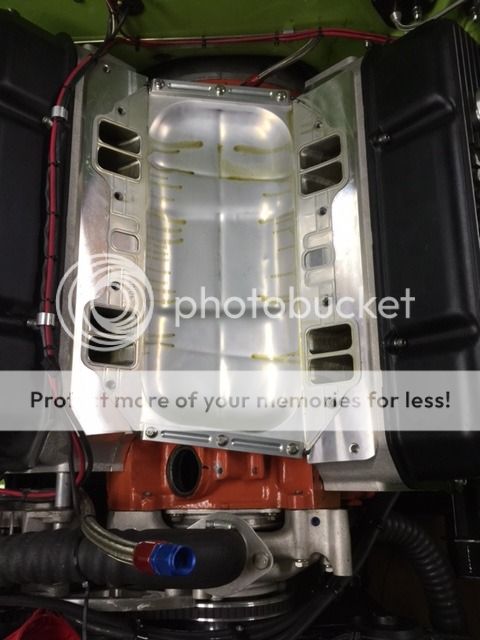

I had an M1 intake on my 383 when I first built it. sealed up just fine. swapped over to the performer rpm intake and it was sucking oil from the lifter valley. I then swapped heads to the trick flow's and the intake leaked with those heads also. after a bit of investigation i have come to the conclusion that the intake was milled incorrectly.
you can see in the last picture that the top of the crush bead is flat and on the bottom of the port the bead is virtually untouched.
I will also mention that the deck has never been cut on this block, the heads are not milled and i am using a standard .039 crushed thickness gasket.

I agree 100% with this........ but....... I dry fitted the intake last night and with the intake sitting in place, no gaskets, all surfaces cleaned. the top of the intake port is sitting flush with the head. the bottom? I have .013 on the driver side and .015 on the passenger side all across the bottom. it varied maybe .001 but hard to tell reaching under the intake with feeler gauges. i shine the light into the plenum and i had a pretty ray of sunshine all the way across on both sides.
here is the kicker! the guy i sold my M1 to lives two blocks down the street. it was still sitting on his bench. I asked to borrow it for few min. lay it down....... LIKE A FLIPPIN' GLOVE!
I understand i have aftermarket parts mating with other aftermarket parts but i would bet the farm that the eddy intake is not milled to the factory spec.
