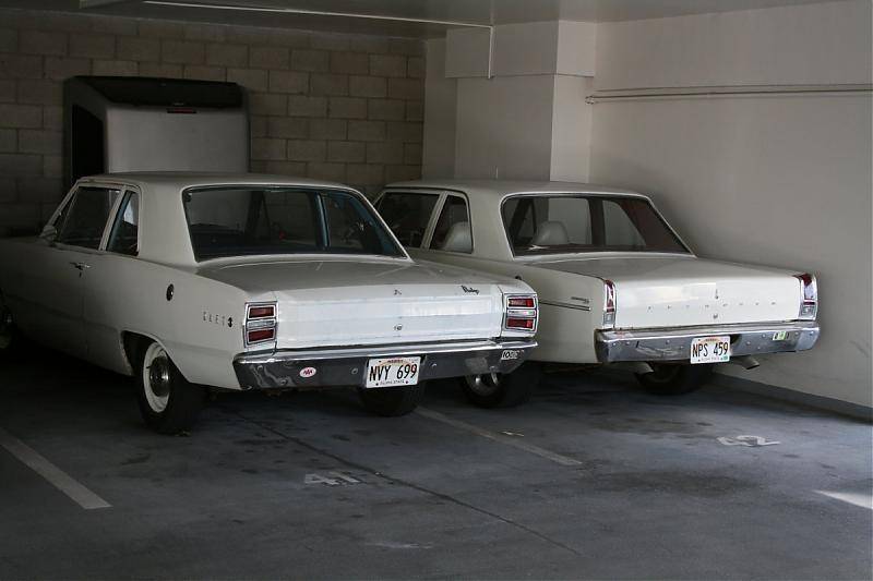

had this done for a couple of weeks. bad pics from cell phone i'll use good camera when i crawl under to re-torque everything, missing in pics is shocks, i wanted the bilsteins but they cost more than i can pay. have a set of kyb's ready to go on, for now i've driven with the drag shocks that were on it and i'm still havin a blast going around long bends in the road.
it handles so much nicer than before.
thanks to dick at firm feel, mancini, ar engineering and a bunch of others to totally transform my car. - aloha

the reason for cage is evident everytime i put it on jack stands, when i let the front down from floor jack onto stands it drops an extra inch or more at the front after landing on stands. theres a whole lot of flex in there.
poly everything, including firm feels greasable lca bushings, adjustable struts, bigger tie rods, 1.06 t-bars, 98 viper calipers using andy's kit, reinforced k member and lcas, reman steering box.
yet to install: new master, proportioning valve, b body rear with 11" brakes, kyb shocks. all those things are in my shop ready to go on the car but i'm to busy trying to clean/paint/sanitize my apt. getting ready for new occupant, basically wiping away the bachelor stuff :)
