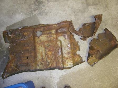

I too know how you feel.. Ya just have to prioritize what you need to do and write it out then stick to your plan.. When I started stripping down the interior of my duster I started with the back and it looked great, then I started taking the carpet out of the front passenger side first. I rolled it towards the drivers side and much to my surprise the floor pan looked in good shape, I then rolled it on over to the drivers side and that's when reality set in.. Rusted completely thru around the seat mounts, pin holed and push your finger the metal in the rear floorboard along with the front where your rest your heels. Since I don't have a compressor to carry air tool loads, I wound up using a "dremel"..LOL... and about 22 cutting discs.. I can say that it gave me a very nice cut line and I didn't even knick or cut any brackets, cables, or brake lines.. Its the old saying "nessecity is the mother of invention"!
PoisonDart gave you some great advice. as well as everyone else does on this forum.
Here's a few pictures, I haven't got it welded in yet but the new is prepped and drilled ready to be welded.. Good Luck and most of all... Have Fun! That's what this hobby is all about...

please dont "glue" anything over the old metal. at the very least you can weld in some new patch metal. 19 shows how it should be done.
One of the most important things if your new at this is to make sure you drill out the spot welds on the old floor pan as well as the ones on a donor car if you go that route. If your floor pan has alot of rust you can take some sandpaper, file or whatever you can find to clean the area where the welds are so there easy to find. And another note of interest these spot welds are not uniform, by that I mean they are not welded every 1- to 2", there is a pattern but they just dont fall perfectly in line.. (simple I know, but I found it out the hard way.. ) Highly suggest you go spend the $12 - $15.00 for the bit thats designed to drill out spot welds. It's worth its weight in gold.. It will only leave a 1/8" hole or so to close up after you drill the spot welds out.. And yes you will need to close them up with a welder and grind them flush for the new pan to fit and not rust through again from the drilled holes.
