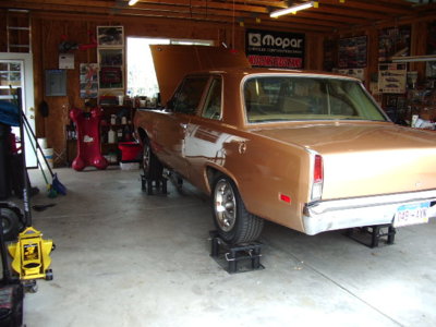

Great news, I put the slant and trans on craigslist, and a fellow Mopar fan needed it for his '73 Dart! He drove up from Colorado Springs yesterday morning, and we loaded them on his trailer. Feels good to be able to help him out. Woke up this morning to snow, so I wasn't thrilled to be working in the cold weather. After it warmed up this afternoon, I went in the garage to do some preparing for the installation. Next thing I know, the 340's in! Haven't been this motivated in a long time.
Next up is stabbing the trans...

Looks good Brock, didn't do the trans with the motor? Big show Saturday, gona be ready?:poke:
Thanks Dave. I have done the trans swaps from the bottom since I got the lift stands. Didn't have to remove the hood for engine swap. I don't think it will be sorted by next Saturday. What show are you talking about?

So I went over to Brock's Sunday afternoon and helped him stick the tranny, you can see the blue dipstick right behind the exhaust manifold, I thought he would've posted up something........just helping you out Brock, see you tonight at therapy!

Thanks again higgs, never had a transmission go in that easy from below! On the garage floor that is...:thankyou:
