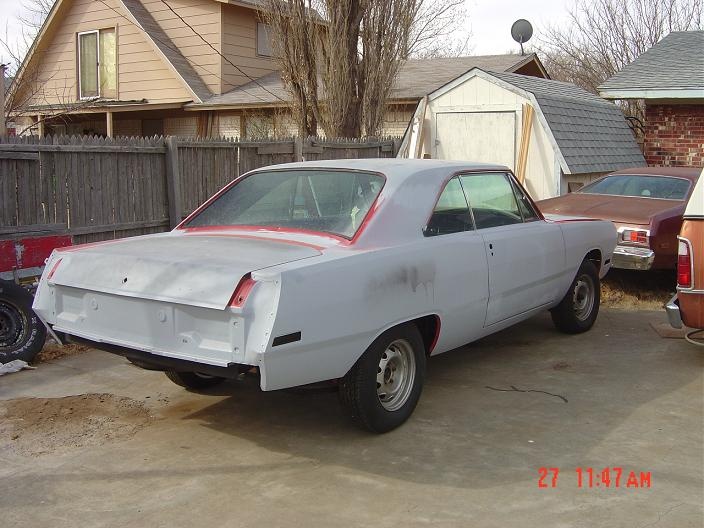

Here is a picture of the Dart. Nothing special that is why I don't want to spend a pile of cash on this motor.
