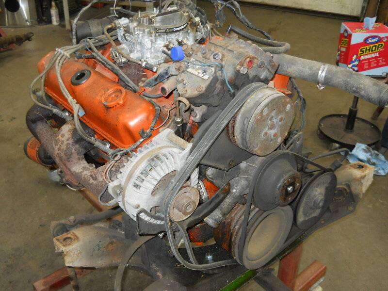

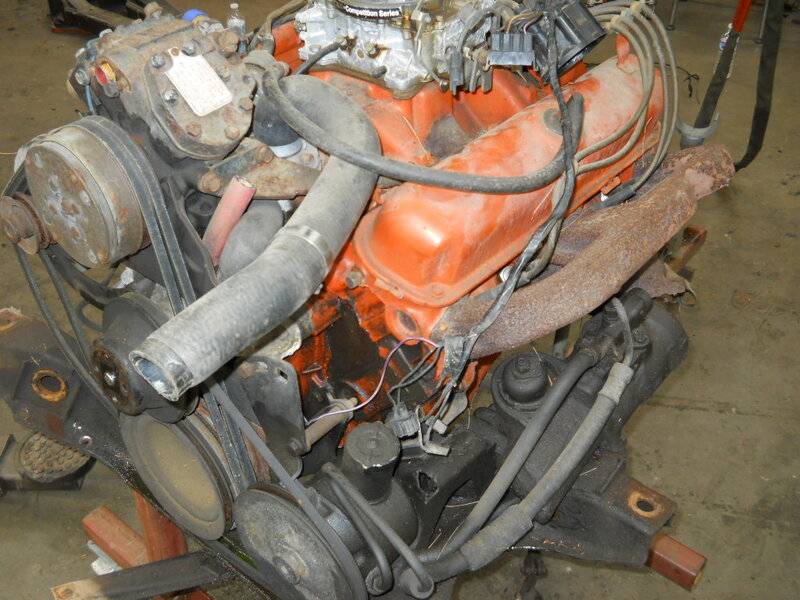

69 and earlier AC with iron pump and 70 and later AC with aluminum pump
So the later model uses a 3 groove crank pulley and the older style a 4 groove. Looks as though the pulley on the power steering pump would be different also.
Look closer. They both use 3 groove crank pulleys.
Early= 1 groove drives the AC and uses an idler and tensioner pulley for belt adjustment. 1 groove drives the (high mount) power steering, and uses the pump to adjust the belt. The last groove drives the water pump and alternator, with the alt. for belt adjustment.
Late= 1 groove drives the (low mount) power steering and water pump, with the ps pump providing adjustment. 2 grooves (double belt) drive the AC and alternator, with the alternator adjusting the belt.
The only time I have seen a 4th groove on the crank pulley is on late LAs when an air pump was added for emissions.
Note that all brackets and pulleys are different due to the different depths of the early vs late water pumps, and are not interchangeable.
