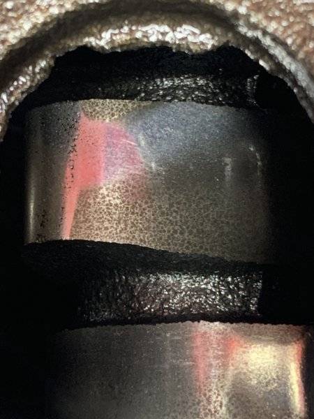

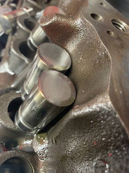

OK guys I have started tearing the motor apart although I found some problems it’s not the original problem but makes it a good reason to tear the motor down I have two lifters starting to have a bad pattern and two lobes starting to get worn down. And it looks like the cam has been running a little bit too far forward I don’t know how that’s possible but anyway that’s all going in the trash Along with the damper of course. The bad thing is I still haven’t found the original problem Why the motor only wanted to run so advanced
