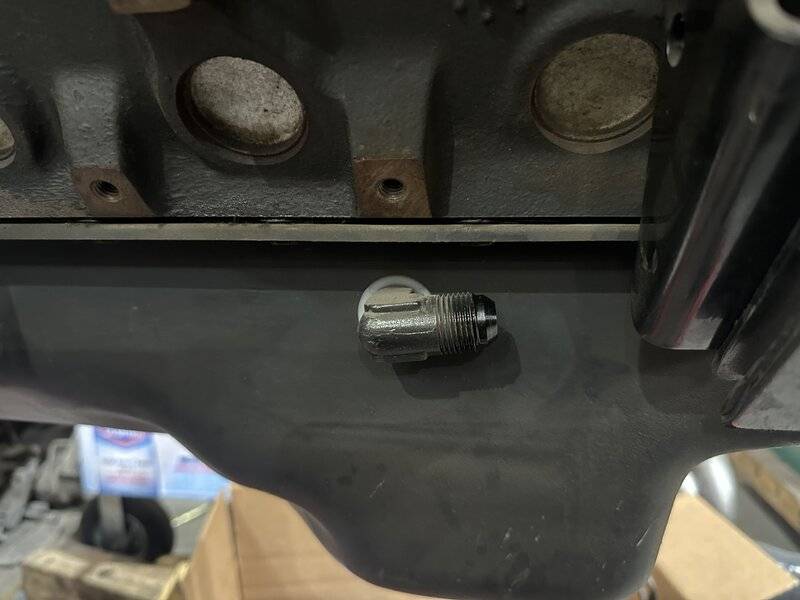

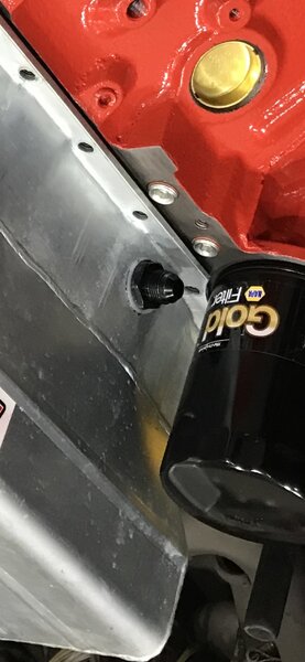

On all of my turbo junk I drill the oil pan just below the pan rail and install a bulkhead fitting. I usually cut the nut in half and after it’s tightened, trim off any excess thread past the nut and tack weld the nut to the fitting.

The directions to the hole on the side of the pan towards the front just below the rail.
Magnum a body pan.
Jet boat BBC pan.
