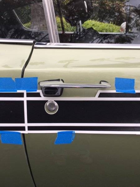

Hi.
We are in the process of installing side stripes from Phoenix graphics.
They need a bit more cutting / trimming than I anticipated.
Please post images (or point me to some) that show;
  • area around door handle / key hole
  • front edge of front fender, trying to see how far forward the strip should go before I trim.
  • rear edge or rear quarter, trying to see how far back the strip should go before I trim.
Sample photo from our project here.
thanks
Craig
Is the black and white the stripe or is there a boarder around the decal that might be forcing the decal down.
Hi,
The black = the stripe.
The white = the backing paper, stripe is not yet applied.
Without any OEM photos i would center the stripe circular opening on the key lock. And go from there
I thought the stripes were folded/continued into the car. On the door rolled around to the inside of the panel.
Alan
Nay that's the Dukes of Hazzard version stripe, "we don't know nothing 'bout opening no stinkin' doors"
I think the excess is overlapped and will be wrapped when applied, he is only mocking up right now.

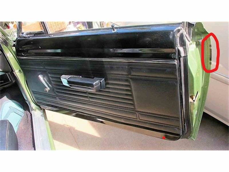

The stripe is folded into the door edges

Thanks for this.
Obviously the Phoenix graphics stripe does not emulate the MOPAR stripe around the door handle.

I just showed one. No one wants an unfinished looking stripe and all of my cars have had taped stripes.

Just an fyi, that door appears to be down some. You may want to correct if possible BEFORE you permanently mount those stripes.
A56 caught it, the door is down about 3/16 of an inch. You might want to check the hinges on both sides & possibly get with MoparLeo about some reworked hinges.
FAXON publishing 1967 to 1969 Dodge & plymouth Body & Electrical Assembly Manual Page 435 has your answers.
In the drawing on that page it shows the hole for the lock with a 0.02" spacing around the lock gasket. It also shows the rear edge of the top strip by the rear of the door handle having a curve to it like the front top stripe by the front of the door handle.
For the life of me I don't understand why reproduction companies don't get the little stuff right. the info is out there and for stuff like graphics it is a change to a CAD drawing and a cut pattern.
This isnt the 1st time I have heard about Phoenix Graphics decals not being oem/factory correct.
Good catch on the door George!
