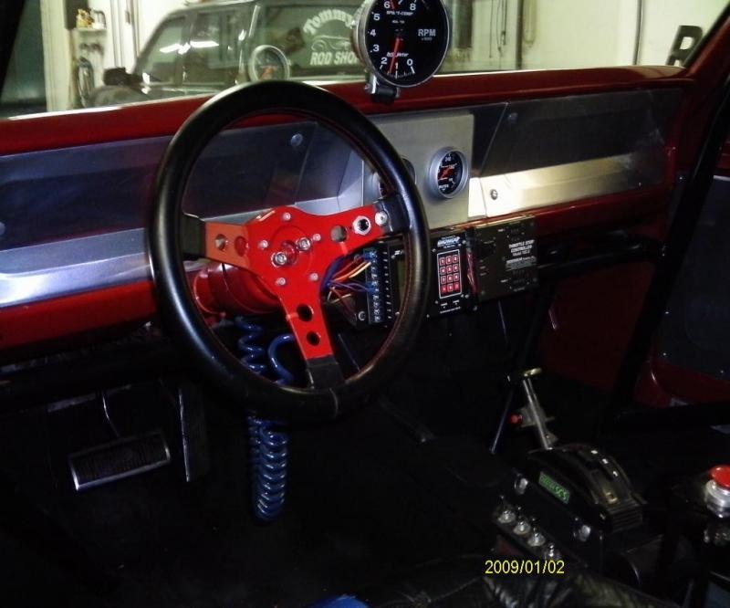

Sweet looking interior 67fish. I like the dash treatment you did.
