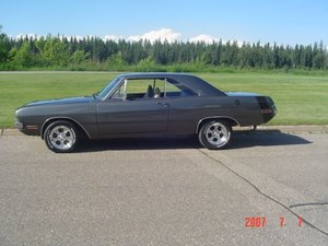

I think i've decided on a color for my dart. Its a silver metallic from summit racing. Choosing this paint because its a lighter color and it wouldn't show all of my flaws in my beginner bodywork hopefully. this is going to be my first paintjob and first time doing real bodywork.
trying to get ideas for the black accents. I think i'm going to paint the entire hood (Including a 6 pack scoop that i'll be installing) a "hot rod black" which is a flat black with a satin finish. thinking about also possibly painting entire trunk lid black. not sure how a black hood and trunk would look on an all silver car.
trying to figure out other ideas for accents that i might do.
If anyone can post pics of silver mopars that they can find. Or of their own I can't find too many pictures of silver darts on the Web.
alll comments and advice are appreciated!

oh those are very mean looking i love the first one good color
Wow, that is a color I had not considered. That is really nice, hope more pics get posted.!
thanks. I hadn't considered it either. I had my mind set on an entire flat black car. but realized that this would show all flaws in bodywork. So I figure this silver still looks very mean! and price is right with summits acrylic urethane paints!
I especially like the last one (GTS) with the black roof and stripe. I'm not sure if it is a factory color or not. It seems like it is a bit darker than the chip in my Martin-Senour book.
