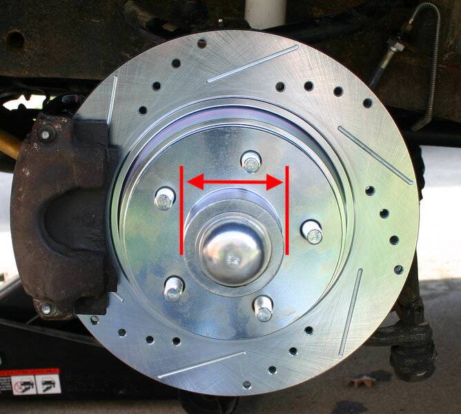

While they're off the car, do you think you could measure the hub diameter? Easy to do, and it could be a deciding factor for others in determining if their wheels will fit this kit.
Explain where you want measured? I'd be glad to measure and post pictures (I have calipers to measure exactly)
The outer diameter of the hub, the part that has to go though the centerbore of the wheel.

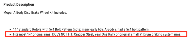

Unlike the '73+ factory parts though which are BBP, the whole point of the Pirate Jack kit is to keep your current SBP wheels. If you can't, then why bother staying SBP? Well, there ARE wheels that do not fit the Pirate Jack rotor. Pirate Jack says so themselves, don't take my word for it.
And boy, if someone would just post the hub diameter on the Pirate Jack kit so that everyone else here could use some common sense when considering the pros/cons of doing that conversion, well, we'd all be better off. The '73+ disks are great, but if you're using them with your existing SBP wheels then you need to make sure that- 1. your wheels have enough backspace, because the 73+ kit widens the track width by almost a 1/2" per side, and- 2. your wheels have a large enough center bore to clear the increased hub diameter compared to some SBP drums. Especially if you're planning on using steel wheels that can't be bored out.

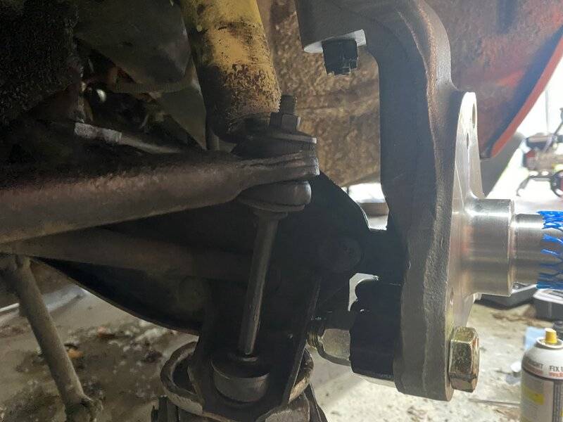

So the 4 bolts that hold the spindle on the lower ball joint hit the lower control arm where the sway bar is mounted. I'm hoping i can get shorter bolts with a differnt (smaller lock nut) and that will help. I did a search but didnt really find any answers how others delt with this issue. It is the MBM kit going on my 71 Demon. Any help would be greatly appreciated.

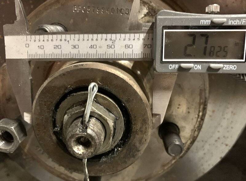

Here's a hub measurement using a set of calipers. As near as I can tell they are 2-1/4" ?
Thank you sir, for posting that and actually letting everyone have the information to find out if this kit will fit with their particular set of wheels.
Normally that measurement is over ~2.7" on the non modified BBP disks. That's A LOT of material to take out. Remember, that material is what supports the bearings on the spindles and ultimately keeps the wheels on the car.

View attachment 1715736696 View attachment 1715736695 So the 4 bolts that hold the spindle on the lower ball joint hit the lower control arm where the sway bar is mounted. I'm hoping i can get shorter bolts with a differnt (smaller lock nut) and that will help. I did a search but didnt really find any answers how others delt with this issue. It is the MBM kit going on my 71 Demon. Any help would be greatly appreciated.
The factory bolt was a weird 1/4" measurement, I think they're 2.75" long? So if you have a regular grade 8 bolt there it's probably 3". @hemi71x special orders the right length, he has them here with the shorter nuts as well...
[FOR SALE] - **BOLTS** Lower Ball Joint To Spindle. A, B, E, Body. Disc & Drum Brakes.
That comes up with any of the 73+ spindles and the early 67-72 sway bar mounting location. The proper way to deal with it would be the bolts and nuts I linked, although lots of people break out a cutting tool to shorten the bolt.
Now that I have the bolt issue fixed, I realized they didn’t give me the rubber brake lines that were supposed to be included, ugh!
