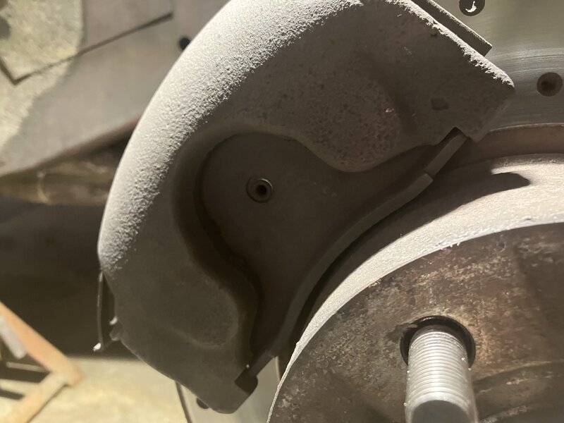

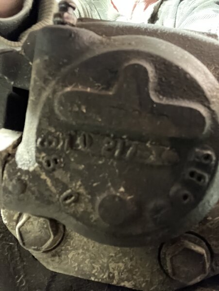

I pulled a set of disc brakes off of a 1980 volare. I had started blowing them apart, and ordered a kit for them.
Problem: the kit does not match the calipers! If someone would take a look at these and help me identify the correct kit I need, please help!
What's your piston diameter? 2.75" I believe is what the B,E,C, FMJ cars used. Should be the same piston as any M body. If the pistons are 2.60" then it's a 73-76 A body caliper.
2&3/4" the Wagner ones are steel. Only 3 left on closeout. You might as well get the seal kits there while your at it.
