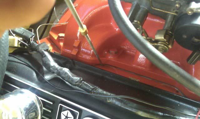

Both of us have gone over this engine high and low with a stethescope trying to locate the problem. We've isolated the tick to cylinder #6, or atleast that's where our best guess it. We did not hear anything on the side of the block. The intake port for cylinder #6 is the spot where we can hear the tick the loudest. Here is a pic of the location where we believe the tick is originating. Or atleast as close as we can get.
Do you guys have any ideas of where we need to go from here? This tick is so loud you can hear it from several feet away with the hood closed and it's driving us crazy! Any help will be greatly appreciated.
