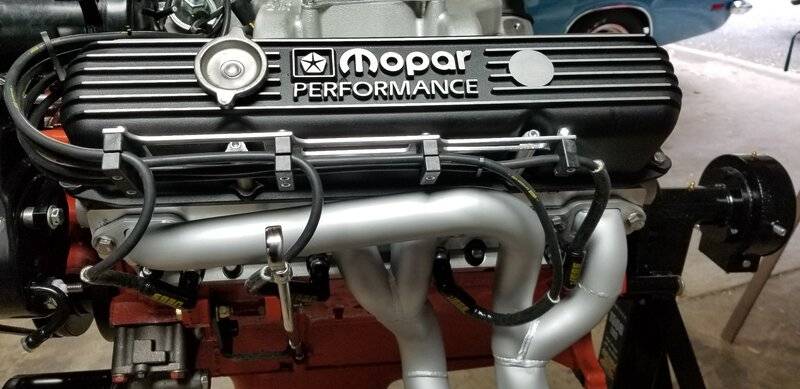

Schumacher, 440 Source heads, all 90 degree, all wires come from the bottom up, including #7 and #8 which are just flipped at the end to run back down. Only #8 needed a helping hand from a bracket, just to be safe.
Driving with this setup for years.

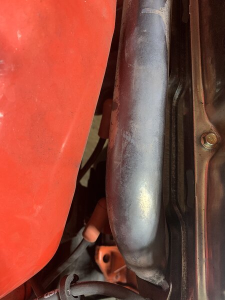

Iirc, the passenger side plugs/boots are pretty close to the inner fender, at least with the headers I have, I don't think those 45s would fit, they also look longer before the bend.
