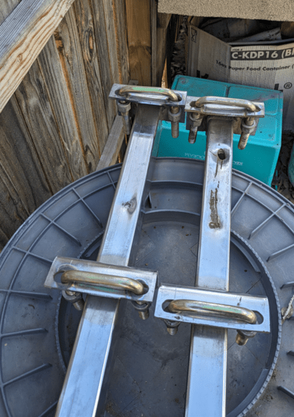

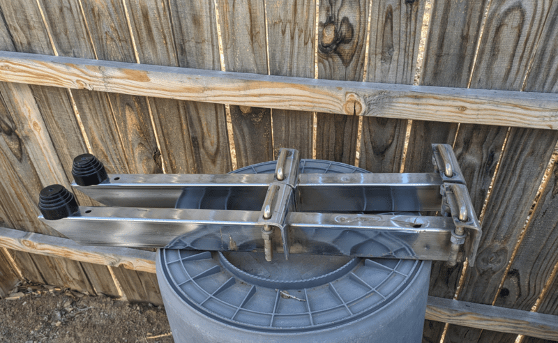

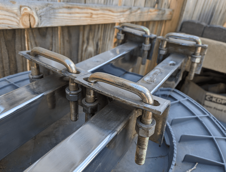

I put Caltracs and split mono leafs on my Duster. However, it did have Lakewood 28" traction bars on it when I bought it years ago. Leaving the line it would pull the front end off the ground with stock springs. The previous owner had one of the U-bolts snap off during a launch. He went ahead and installed larger better and quality U-bolts, then welded more around the bars all around and put better pimp stops on them. Anybody looking to buy a used set I'll let them go for $50 plus shipping. Would be shipping from New Mexico.
