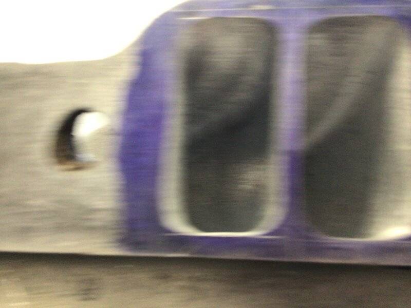

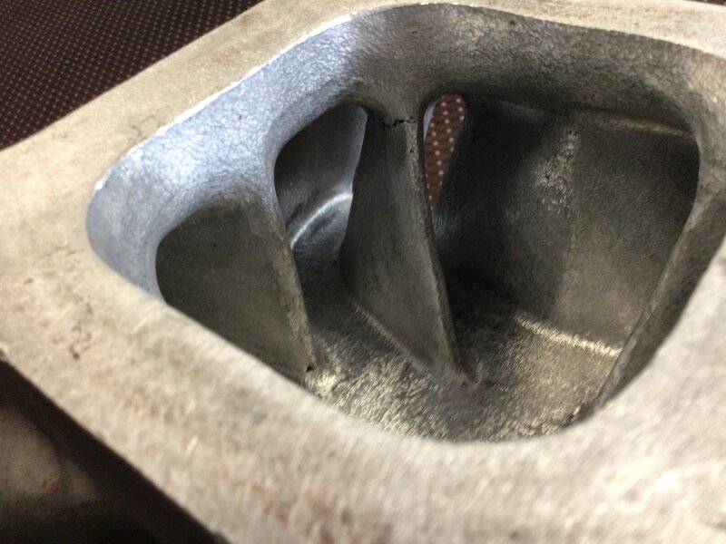

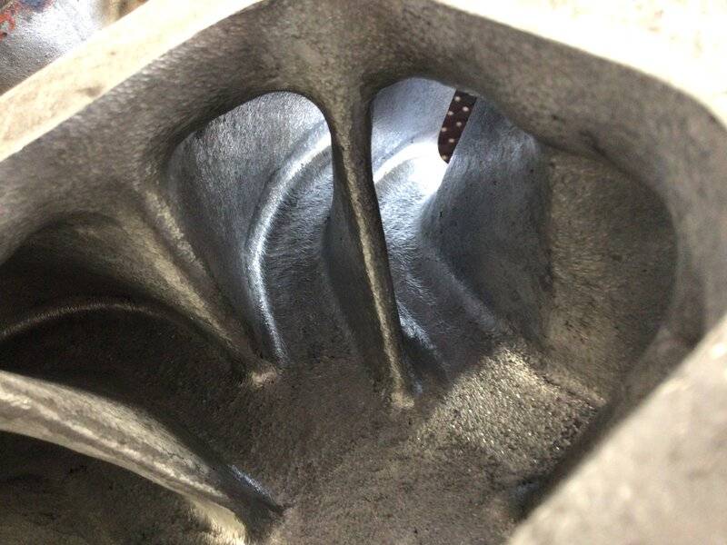

My guy got on it before i thought he would. Very happy with his work.

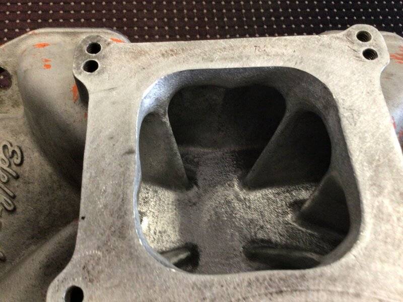

Gotta clean the intake up yet, and get it painted black to match my engine. The top of the intake isnt “ tall “ enough to match the new heads without welding. I chose not to do that. Its doesn't have the available meat like a super Victor, but with a flat hood, that wasn't an option. We made it as compatible up there as possible
This thing is miles better than my little Excellerator
That’s some trick looking work! Not lining the top of the port off shouldn’t be a too much of a penalty. There have been some successful engine masters builds were the intake port roof was shorter than the roof of the head port to act as a reversion dam.

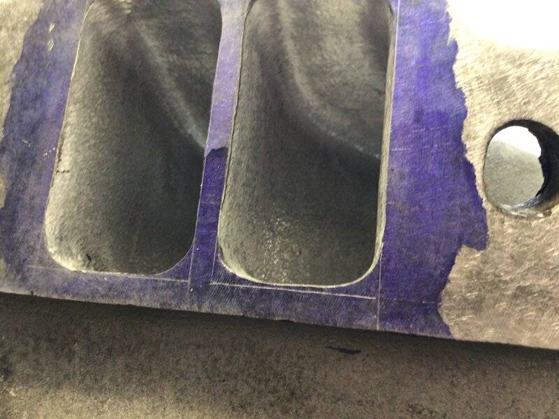

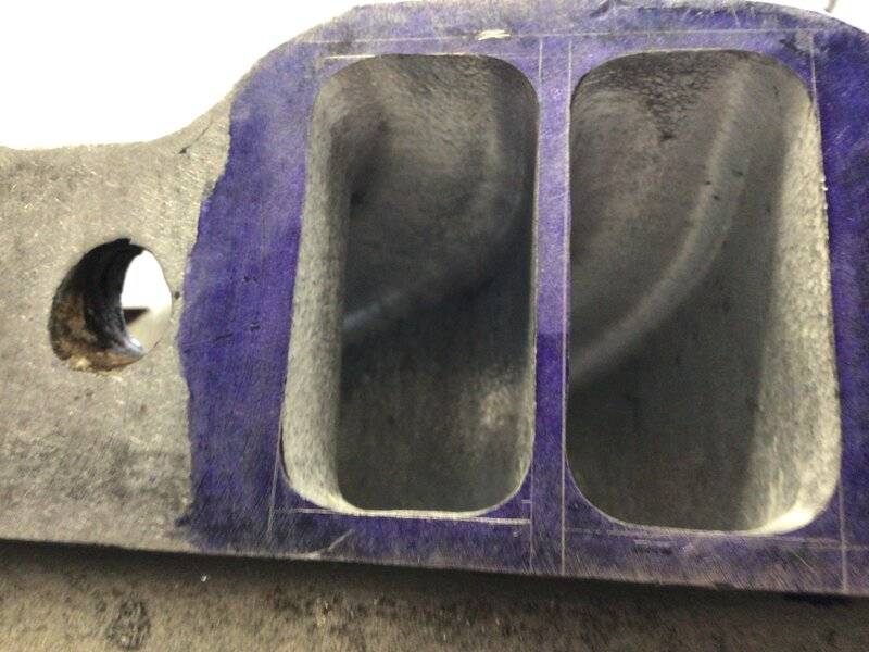

Did you have the heads to actually compare openings yet? Bloomer heads are really low on the bottom as well. Looks great though, should run awesome with new combo
I'm interested to see this come together. I got some new Bloomer heads also, and I have a victor 340 intake also. Mine won't be together for some time though.
Rod gave me exact measurements. The floor isn't an issue at all, just the top.
I am trying to be realistic about the gains i will see. Not opening the valve much..or long, and small headers. Kinda actually wasting the heads.
If this was 10-12 years ago and i was younger…660 lift 270@ 50 roller, headman race headers..yada, yada..but i am not..lol
Hoping to see some pics of the heads, too. What little I have seen of them looked pretty impressive.

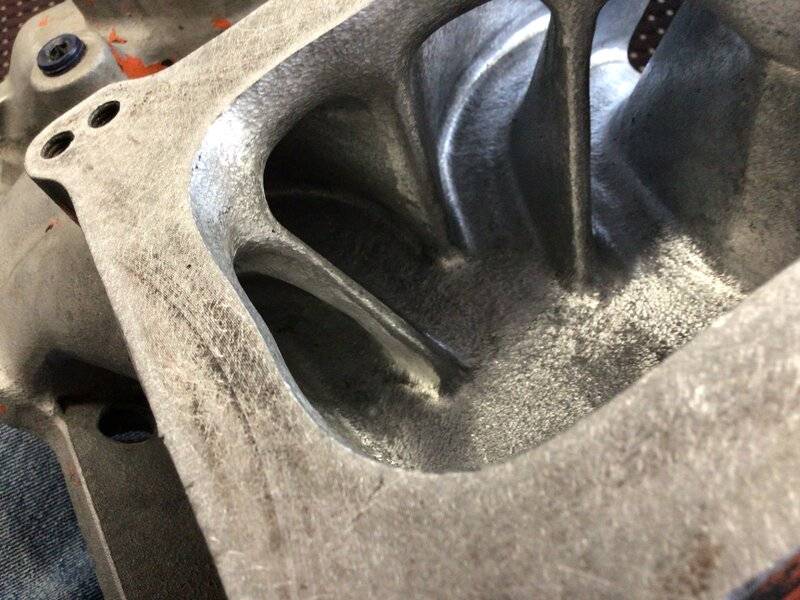

That’s nice work. Love the burr finish. I can tell you that will certainly increase the power all across the curve for sure.
he talked about his preference of using the burr finish. Said it promotes fuel atomization.
His real speciality is doing Harley heads.. he is very handy.
Thanks. I value your opinion a lot!

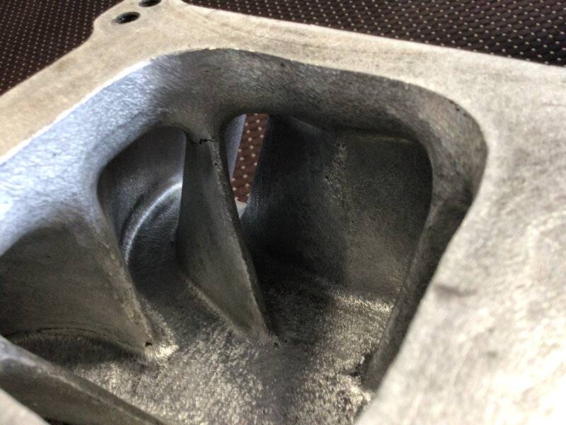

thanks for sharing the pics.....i see where i can improve mine (bigger radius from the plenum top to the runners). Pretty interested in your findings with the bloomer heads, please keep us updated!
