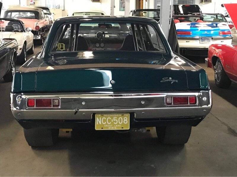

I have 295 50 15 on the rear
stock axle housing custom 10" steelies with dog dish caps with 7 1/4 backspace
on the front i think they are too small for my liking but they are 185 55 15

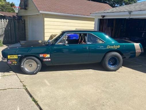

Rears are sports man SR2'S 29x12.5x15 and fronts are the same tire on 28x4.5x15

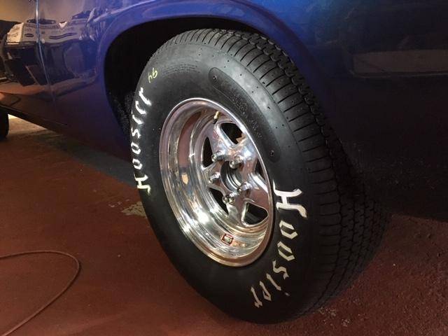

I wanted to be sure they cleared at the front of the tire so while doing the mini tub I moved the axle back 3/4". Turns out it wasn't an issue, now I still have room to go taller which I will be trying in the future when I can afford tires and gears. The 325/50's are 28" tall and I have about 1.25" from front of tire to that lower corner on the quarter panel, leaving room to go 29" easily
28x12.50R15 sportsman pros on 11.25" weld RTS-71 wheels.

325/50-15 et streets on a 12" rim. 325's are 14" wide on the 12" wheel. If you want the car low i would suggest removing the outer house on the wheel tubs if you want a wide wheel that not inward of the quarter.
